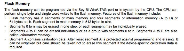

    Info memory is divided into 4 segments of 64B each. Info A is only one of these segments and it can contain calibration constants as mentioned in the datasheet:
    Mass erase is always required and the parameters you mention look OK.
    Luis R

    Before reprogramming, I did notice that some of msp430 chips have already 10 bytes data from address 0x1000(in Segment D).
    Only segment A could be restored, once I use "+aepvrw" to reprogram the chip. Segment B,C and D are erased.
    Any side effect it may cause or any concern if other segments except for A in information memory are erased?
    i.e., Segment B,C and D are irrelevant for general development?
  • Only InfoA has calibration data. Please refer to the corresponding datasheet for more information
    Regards.
    Luis R
