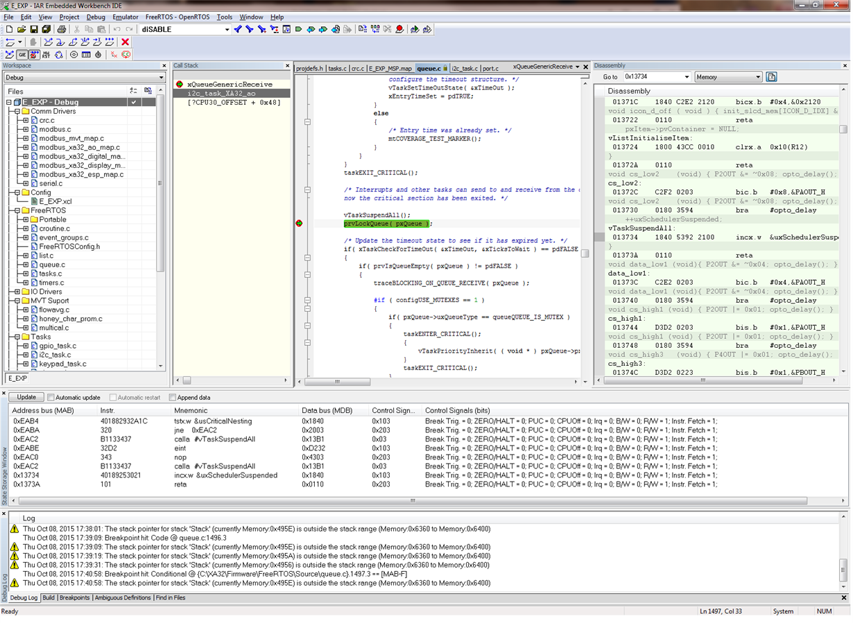

Normal Operation Screenshot
Crash Screenshot
Thank you and I appreciate the help!!

    Can you try re-posting the mentioned screen shots? I am not seeing them for some reason or another.
    I agree with Clemens that the issue you are seeing could be related to CPU40 and that using the high balanced IAR compiler utilizes the NOP workaround that the default compiler fails to implement. In this case manually inserting NOPs between the jump/conditional jump instruction and program code might help, but I'm not sure how feasible this is inside of FreeRTOS. is an author of the MSP430 IAR compiler and may be able to provide more support regarding the differences between the default and high balanced compilers.
    Ryan
  • Sorry about that, I went ahead and added them to the bottom of the post.
    -Javier

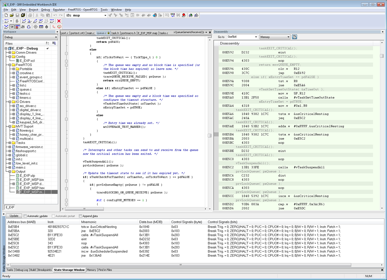

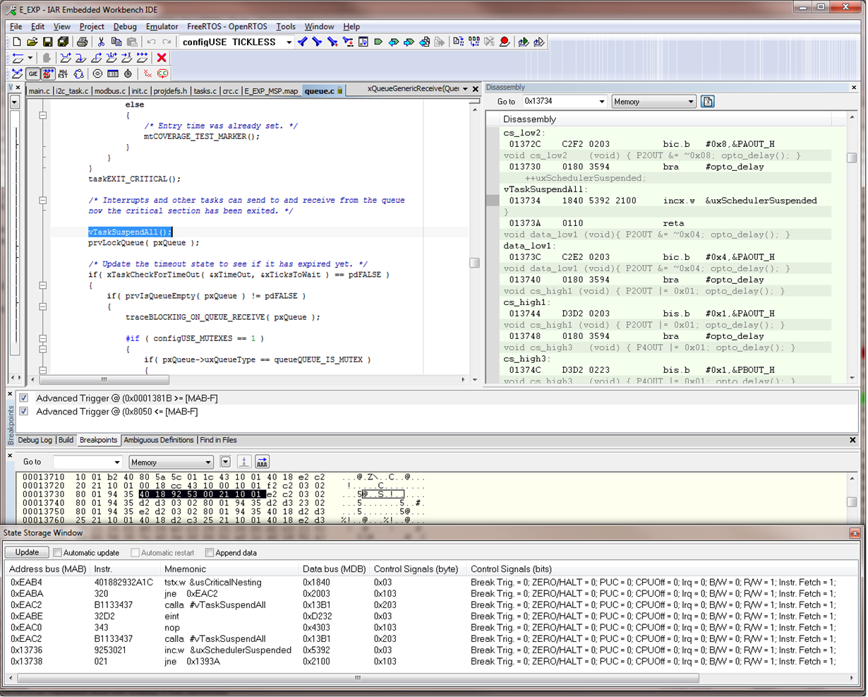

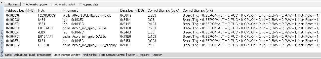

  • Below, I will attempt to provide more screen shots which include the various parts of code that have been requested.  This code is slightly different than in the previous post as I did continue development on some other areas of the application - these addresses will not match addresses in earlier screen shots.
    This first screen shot shows current execution point when the break point occurred.  The breakpoint was configured to trigger anytime code is executed outside of the actual code ranges (PC<=0x8053 or PC>=0x13434).  The PC seems to indicate that the jne 0x136A0 in the State Storage Window was probably executed since the current PC is 0x136A0 as shown in the CPU Register View.
    The next two screen shots show the disassembly window and code window at the various points along the execution path in the State Storage Window.  This first screen shot is in the xQueueGenericReceive function in the FreeRTOS queue.c file.  The "calla #vTaskSuspendAll" is where the problem seems to begin.

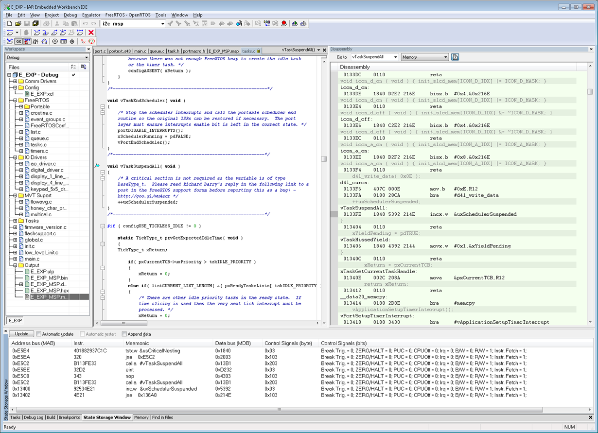

    The next screen shot shows the code and disassembly window for the vTaskSuspendAll function.  The calla to this function is where the first evidence of something going wrong seems to occur.  The calla was supposed to jump to 0x133FE but the State Storage Window looks like the calla jumped to 0x13400 which is 2 bytes past the intended jump address.  This causes the instructions executed for VTaskSuspendAll to be incorrect.  Address 0x13402 contains the jne 0x136A0 instruction which appears to have actually been executed as shown in the first screenshot when the breakpoint occurred.
    As was mentioned previously, I would agree the first occurrence of address 0xE5C2 (calla #vTaskSuspendAll) in the State Storage Window is probably due to CPU37.  I would think that the nop at 0xE5BC was actually executed instead.
    Just as a reminder, this crash seems to be fairly random.  It may crash immediately when I start testing or it may take several minutes.  I wonder if it could be related to interrupt timing.  It definitely occurs quicker when I am sending the i2c messages as quick as possible with no delays.  I assume that if an interrupt service routine was called during the code sequence shown in the State Storage Window, it would have actually shown up in the window.  Is that correct?
    I assume that CPU40 would not apply if a "jump/conditional jump instruction" executes and then an interrupt (which changes the PC) occurs.  Surely this would not be a problem or we all would have see it.
    One other thought is that the board I am using has an MSP430F5335 that has a marginal problem.  I will confirm that I see the same results on multiple boards tomorrow and update my results with a post.
    Could USC139 be the problem?  This may be the i2c errata that you were thinking of.  The description says that Unpredictable code execution can occur.  I wonder what exactly "unpredictable code execution" means.  Does this make since at all with what is in the State Storage Window?  I have tried updating the portENABLE_INTERRUPT macro in FreeRTOS to apply the USC139 work around but I still saw the same type of crash.  Here are the two alternate versions I tested:

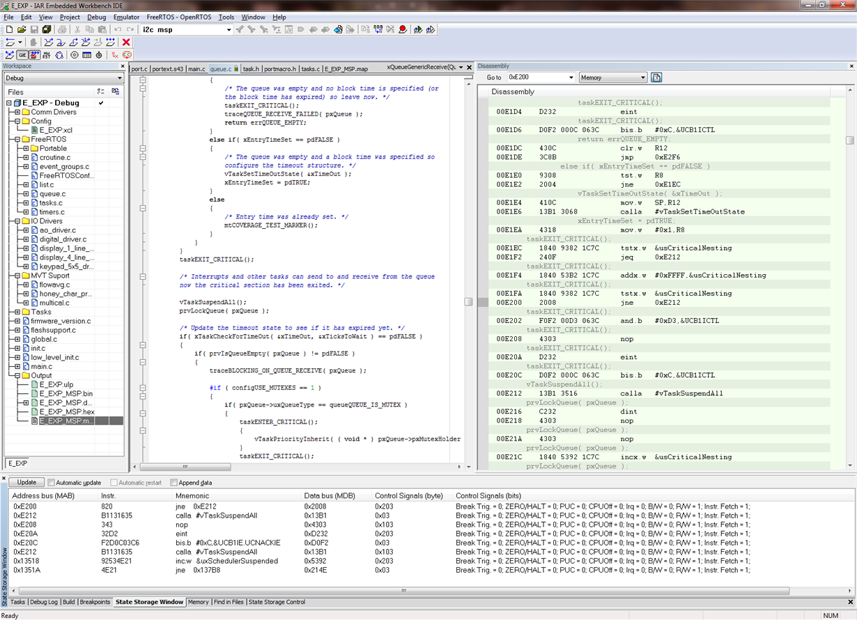

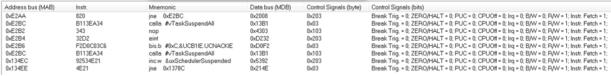

  • Here are the same three screen shots with the USC139 workaround added.  It seems to be the exact same crash.  I am still assuming that CPU37 is causing the first instance of "0xE212 calla #vTaskSuspendAll" to show up in the State Storage Window.  It should have shown the "0xE202 and.b   #0xD3,&UCB1ICTL" instruction which I believe was executed.  The "calla #vTaskSuspendAll"still seems to be jumping 2 bytes past the target address for some reason.  It did take several minutes of continuous i2c communications before the crash happened.
  • I'm just flailing around blindly here, but could you just insert a bunch of _NOP();s before and after the call to vTaskSuspendAll(), to see whether it makes any difference?
    In the worst case, you could insert a _NOP() at the beginning of vTaskSuspendAll(), but I wouldn't be happy not knowing what causes this.
  • After several days of testing this problem on 4 separate boards, I have all but convinced myself that this may be a CPUXv2 bug on the MSP4305335.  Hopefully someone can point me in the direction of why this is occurring and how to solve it without the Band-Aids described below.  I have narrowed the failure down to 2 different scenarios of which I have observed on all 4 boards.  In the process of debugging, I have made many small changes in the code which cause the actual position of the functions involved to be located at different memory addresses.  The same 2 exact failure scenarios occurred, at same 2 spots in code through all of the code versions.
    I can’t explain why these two failure modes would occur and am very concerned at this point about the reliability of my entire application.  Even if it runs with the fixes described below, as the development continues surely these types of problems would show up again.  I really need some help to understand the root cause.
    Here are the details on each of the two failure scenarios.
    1) First Failure Mode
    The “calla #vTaskSuspendAll” instruction jumps to an address which is 2 bytes past the target address.  I am sure there are lots and lots of calla #address instructions throughout the application.  I am not sure why this one would be so special.  It always occurs at the exact same spot in the code in FreeRTOS where the xQueueGenericReceive function calls vTaskSuspendAll.
    Here are the details of what occurs during this failure:
    Code from disassembly window in IAR EW430 v6.30.3:
    This is the State Storage Window after a breakpoint triggers on an instruction fetch outside of the actual code range. Note: I believe the first occurrence of address 0xE2BC calla #vTaskSuspendAll in the window is due to CPU37, the instruction at 0xE2AC is actually executed since the jump was not taken. You can see that the second occurrence of 0xE2AC calla #vTaskSuspendAll actually jumps to 0x134EC instead of 0x134EA as specified in the calla instruction. This causes invalid code to execute which includes the 0x134EE jne 0x1378C which is jumping to an invalid address and triggering the breakpoint.
    Here is the CPU Register window and disassembly window right when the breakpoint triggers:
    As a test recommended by Clemens Ladisch, I inserted a __no_operation() as the first statement in the vTaskSuspendAll() function.  This would allow the calla to work correctly if the target address hits on the correct address or 2 bytes beyond.  This seems to have fixed (“put an ugly Band-Aid on”) the problem.  I have been running the code with this patch along with the one described below on item 2 for about 5 hours now with no failures.  Previously, I would have seen the problem on at least one board after about 15 minutes.
    Here is the disassembly window showing the fix that was added in the code that does not crash:

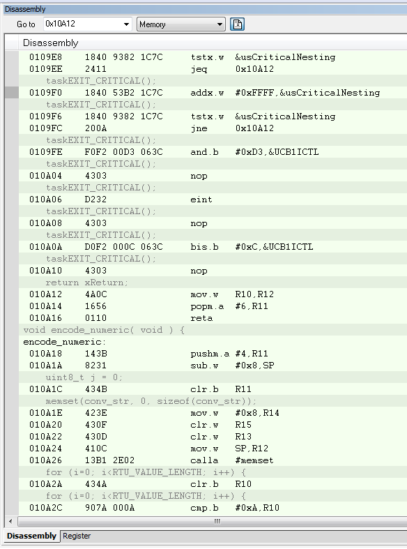

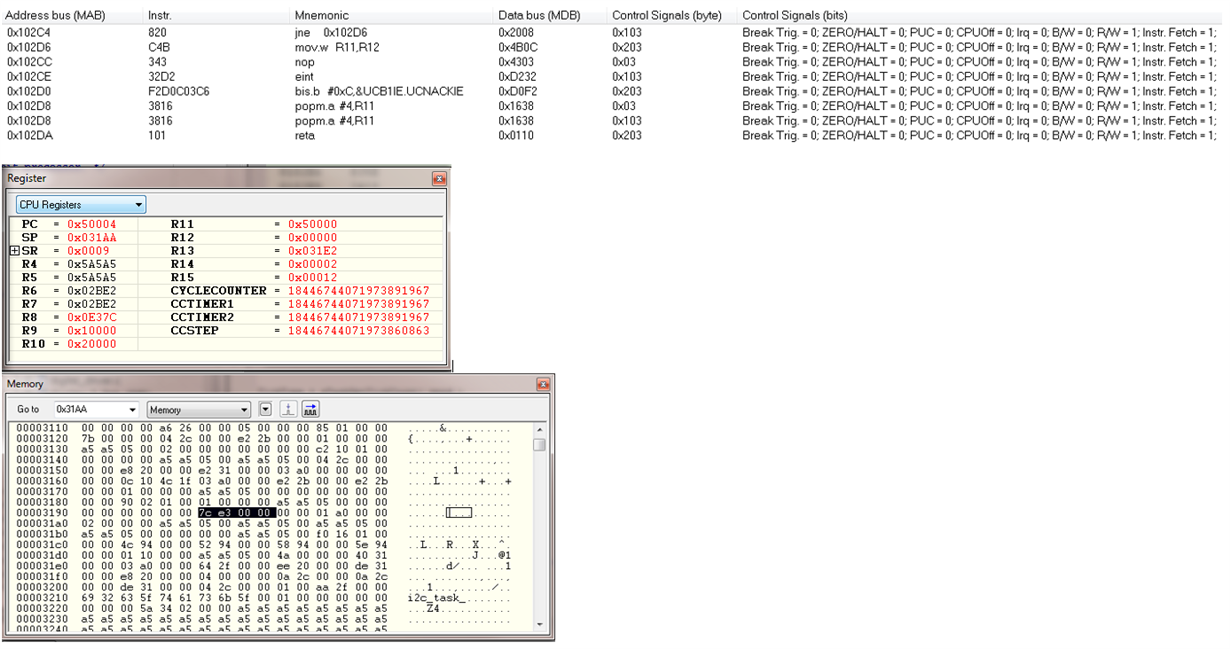

    2) Second Failure Mode
    The second failure mode that I have observed is when a single “popm.a #4,R11” instruction appears to be executed twice leaving SP pointing to the wrong place for the reta instruction.  When the running function exits with the reta, the program returns to a location outside of the actual code area triggering my breakpoint.  As with item 1 above, this failure seems to occur at the same spot each time in code also, even with various small changes in the application which shift the addresses.  This one occurs at the end of the xTaskResumeAll function when it tries to return to the XQueueGenericReceive.
    Here is a detailed description of this failure mode:
    Code below is in xQueueGenericReceive where xTaskResumeAll is called
    Code below is at the end of the xTaskResumeAll function where it should return from the above call.
    Below is the State Storage Window, along with the CPU Registers and a memory dump of the stack area at the time the breakpoint triggered.  You can see the double execution of the popm.a #4,R11 instruction in the state storage window.  You can also see in the memory dump of the stack that the correct return address (0xE37C) was actually on the stack (highlighted in the memory view).  At the time the reta was executed, SP was positioned 16 bytes (4*4) higher in memory due to the extra popm.a being executed.  This caused the reta to go to 0x50004 instead of 0xE37C like it should have.  Looking at the register view, SP is pointing to 0x31AA when the breakpoint occurred (after the reta).  The previous 4 bytes on the stack would have been used for the reta: 05 00 a5 a5.  I believe this would have given a return address of 0x50005 – with word alignment would become 0x50004 which is seen in the current PC.  If you look at the 4 previous 4-byte values on the stack, you can see that they were popped into R8..11.  R8 received the return address that should have been used for the reta.
    Disassembly window at time of breakpoint:
     I decided to try adding some extra NOP’s before the popm.a instruction as a test.  This appears to have fixed (another big Band-Aid) the problem.   This modification along with the extra NOP described in item 1 have been running on all 4 boards with no failures for the last 4-5 hours.  I have been running the code with this patch along with the one described above on item 1 for about 5 hours now with no failures.
    Below is the modified C code at the end of the xTaskResumeAll function along with the resulting disassembly showing the fix that was added in the code that has not crashed so far:

    This version seemed to fix the first failure spot (calla #vTaskSuspedAll) described in my previous post.  Calling into the double nop's would probably be ok if the target address hits 2 bytes past the intended address.   The second failure spot described previously still had a problem.  It seems like the PC went to 0x102D8 instead of 0x102D6 after the 0x102D0 bis.b #0xC,&UCB1ICTL instruction was executed.  Further code execution was then in trouble...
     The disassembly and State Storage Window are shown below when the breakpoint triggered outside of normal code space:

    In disassembly window:
    00E2BA   D0F2 000C 063C    bis.b  #0xC,&UCB1ICTL
    In state storage window:
    0xE2BA  F2D0C03C6    bis.b  #0xC,&UCB1IE.UCNACKEI
    Thanks again for all your help,
    Greg Dunn
  • Here is the latest information on my issue.
    I think I have found a modification to the FreeRTOS portENABLE_INTERRUPTS macro that seems to correct the crashing problem, at least during an overnight test on 4 boards anyway.  Here is the updated version of the macro:
    #define portENABLE_INTERRUPTS() UCB1IE &= ~(UCNACKIE+UCSTPIE+UCSTTIE);  \
                                       _NOP();                                 \
                                       _EINT();                                \
                                       UCB1IE |= (UCNACKIE+UCSTPIE+UCSTTIE);   \
                                       _NOP();                                 \
                                       _NOP();                                 \
                                       _NOP();                                 \
                                       _NOP()
    The first four instructions are taken directly from the workaround recommendation for USCI39 in the MSP430F5335 Errata Documentation.  The remaining 4 nop's were required to keep the various crash modes described in the previous posts from occurring.  If I use 0 to 3 nop's at the end of the macro then the crashes will still occur.  I am not sure what kind of strange execution may be occurring during these nop's, but I would imagine that some of them may be skipped or executed twice at times based on what I saw in the previous crashes.  Apparently, the issue corrects itself by the last nop and the code afterward functions properly, at least as far as I can determine at the moment. I am not sure if these problems were all related only to USCI39 or if they are triggered by some other type of scenario in combination.  While investigating the problem, I have tried changing PMMCOREV, DCORSEL and several other settings to see if they make a difference but I found the problem always stayed the same.  I am running from XTL1 with a 32.768KHz crystal and using the FLL to generate MCLK = 7.995392 MHz.  I have monitored the single 3.3 volt supply which feeds DVCC1, DVCC2, DVCC3, AVCC1, and VBAT and no significant noise spikes are observable.  Each DVCCx, and AVCC1 pin has an individual 0.1uF ceramic cap located close to the respective pin.   VBAK has a 4.7 nF cap.  The pc board is 4 layers and uses internal ground and power planes.  To this point, I have only tested at room temperature.  I plan to test this new fix over the full operating temperature range.  I suppose there still is a possibility that something else in my application is the real culprit in the problem, but I fell that it is a pretty remote chance given that 4 simple nop's correct the problem.
    Based on all of these issues, I have a few more questions that I would like to have detailed answers on:
    1) At the point, I have disabled all of my low power mode code.  The final version does however require the use of low power modes.  I know from other posts that only have limited answers, it may be necessary to add some special handling for USCI39 when your enter and exit LPM.  I believe in my application, I will not require i2c triggered wakeup from LPM, so I can probably just disable the i2c IE flags before entering LPM and enable after wakeup.  I would however like to have detailed steps for the proper procedure to follow to deal with USCI39 if it may affect operation.
    2) Every time an interrupt service routine is exited with the RETI instruction, SR is popped from the stack which will normally always set the GIE bit.  Is there any special handling required at this point to deal with USCI39?  Other threads have mentioned this possible area as a problem but no definitive solutions have been provided.
    3) What other areas should I focus on checking that could cause these types of problems to occur (calla #FUNCTION jumping 2 bytes past target and instructions being skipped or executed twice).
    Greg Dunn
  • Hi Greg,
    I apologize for my absence from this thread but am glad that you've narrowed the issue down to the USCI39 errata. In typical applications once the GIE bit is set (commonly during initialization) it is not reset elsewhere except for entering an interrupt. There are time-critical applications that call for disabling interrupts, such as writing to flash, but this does not seem to apply to your application and in any case I would recommend disabling the IFGs themselves or simply re-doing the USCI39 workaround afterwards. I don't know too much about FreeRTOS operation so it would be beneficial to search the code and make sure that _DINT(), or disabling interrupt commands in general, is not used or required for your application. Regarding interrupts, you will have to disable the hardware-clear-able IFGs upon entering the ISR so that these bits are not set when the ISR exits, which would then set the GIE bit. This also requires the hardware-clear-able IFGs to be set manually (and the insertion of additional _NOP()s) after the return from each ISR. Also note the GIE rules provided in 1.3.4.1 of the User's Guide.
    The hardware-clear-able IFGs can toggle as much as possible without causing the errata so long as the USCI39 workaround involving setting the GIE bit first has been accomplished. I do agree in your confusion though about the need for the extra _NOP() instructions afterwards. Can you please tell me what the following instructions are after the code segment you've provided? I notice that you're operating at a MCLK of 8 MHz which is 8x faster than the default 1 MHz for which the errata workaround might have been tested, therefore a further delay might be warranted depending on the following instructions. I would have to ask our Systems Team for further investigation and clarification of the USCI39 workaround, this might simply be something that needs to be added in the description.
    The abbreviated answers to your questions are as follows:
    1) I agree with your workaround assessment and would advise re-setting the hardware-clear-able IFGs followed by four _NOP()s after waking from LPM, which occurs through an ISR that resets and set the GIE bit.
    2) I would advise incorporating your USCI39 workaround after each return from interrupt.
    3) The types of problems you've experienced are a direct result of the "unpredictable code execution" defined by the USCI39 description so I can assure that other areas of your code will not replicate this issue so long as USCI39 has been resolved.
    Ryan
  • Further investigation revealed that from CPU perspective there is no available workaround to avoid the USCI39 bug. Whatever the code might be, if the USCI self-clears the interrupt within a few cycles of CPU enabling these interrupts then the BUG can be observed. This includes GIE commands from ISR RETI instructions. The USCI cannot use self-clearing interrupts to completely avoid this bug.
    The good news is that most master operation modes are not affected by USCI39. UCSTTIFG and UCSTPIFG are generally used for slave mode operation so there is no concern over those IFGs causing the errata. If using the UCNACKIFG there is still a concern about UCNACKIFG setting within a few cycles of exiting an ISR, but NACKs should be quite rare given that the slave devices should be returning ACKs instead.
    Ryan
