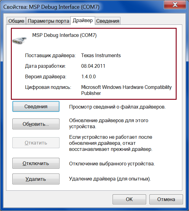

    Here is Device Manager View:

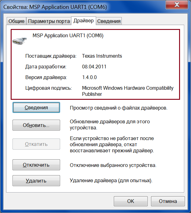

    The COM 6 and COM7 properties:

    COM ports in Device Manager:

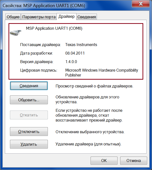

    The COM ports properties:

    Hardware works fine on other computer, it is not hardware issue, you are right. There is drivers issue, I think.
    Can I try to use other versions of drivers, for example MSPDS-USB-DRIVERS (www.ti.com/.../mspds
    The MSPDS-USB-DRIVERS should already be installed since it's packaged with CCS, however, re-installing the drivers/CCS could help resolve this isssue. Additionally, I would recommend you try to use the MSP Flasher linked at www.ti.com/.../msp430-flasher just to determine if the debugger could in fact communicate with the PC and the MSP430 device. You could run some sample commands in the Flasher to test.
