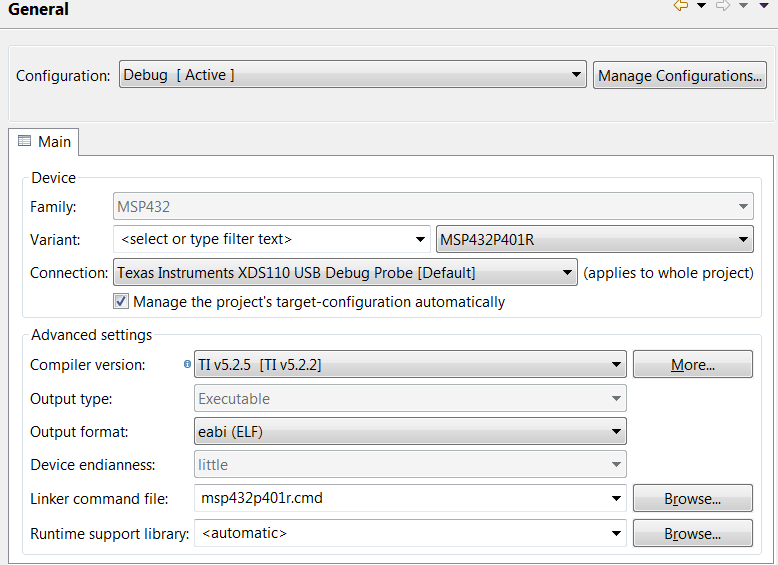

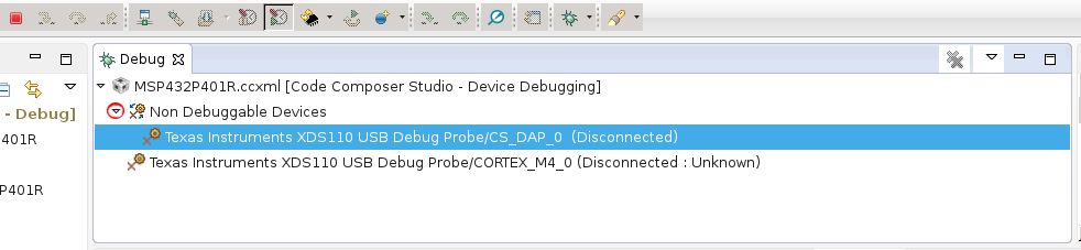

When I got the MSP432, it worked fine, but after I played around with the MSPWare code examples, it stopped working. So the problem is, that when I'm trying to enable the CCS debugger, it gives me a following error:
Error connecting to the target:
(Error -1063 @ 0x0)
Device ID is not recognized or is not supported by driver. Confirm device and debug probe configuration is correct, or update device driver.
(Emulation package 6.0.14.5)
I have been trying to solve this problem by googling and using other peoples solutions on this site. However, none of these solutions have worked yet. The board has XDS110 emulator.
Here are some things that I have tried:
- I have tried to reset the device to factory settings via the Code Composer Studio, by debugging a target configuration file, and then clicking Show all cores --> Connect target in the debug window, but I'm having the same error code as above
- I also tried to reset the device to factory settings via the CCS Uniflash, but I'm having the same error
- I have updated the XDS110 firmware (using the .../ti/ccsv6/ccs_base/common/uscif/xds110/xdsfu)
- I have installed all updates from CCS
