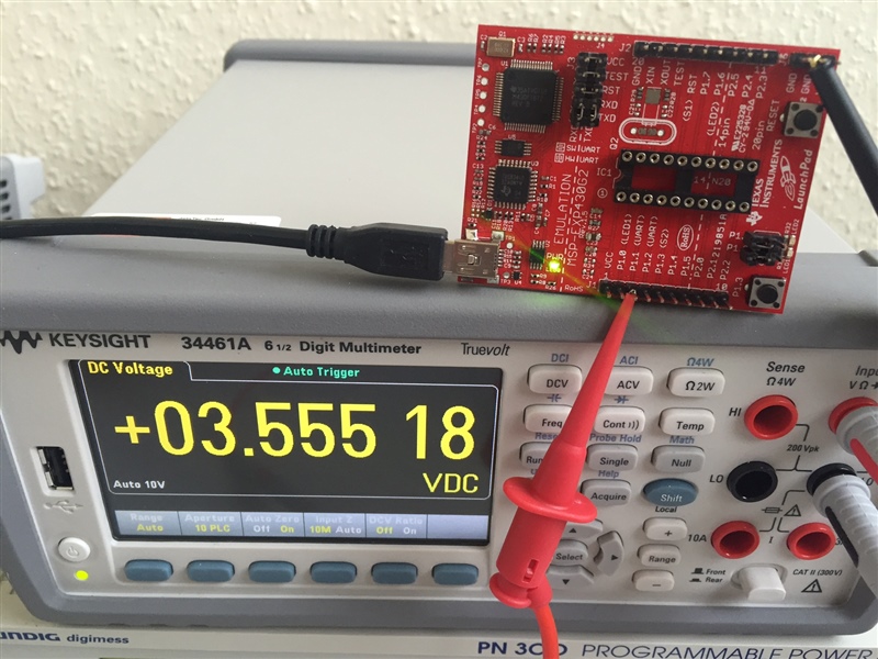

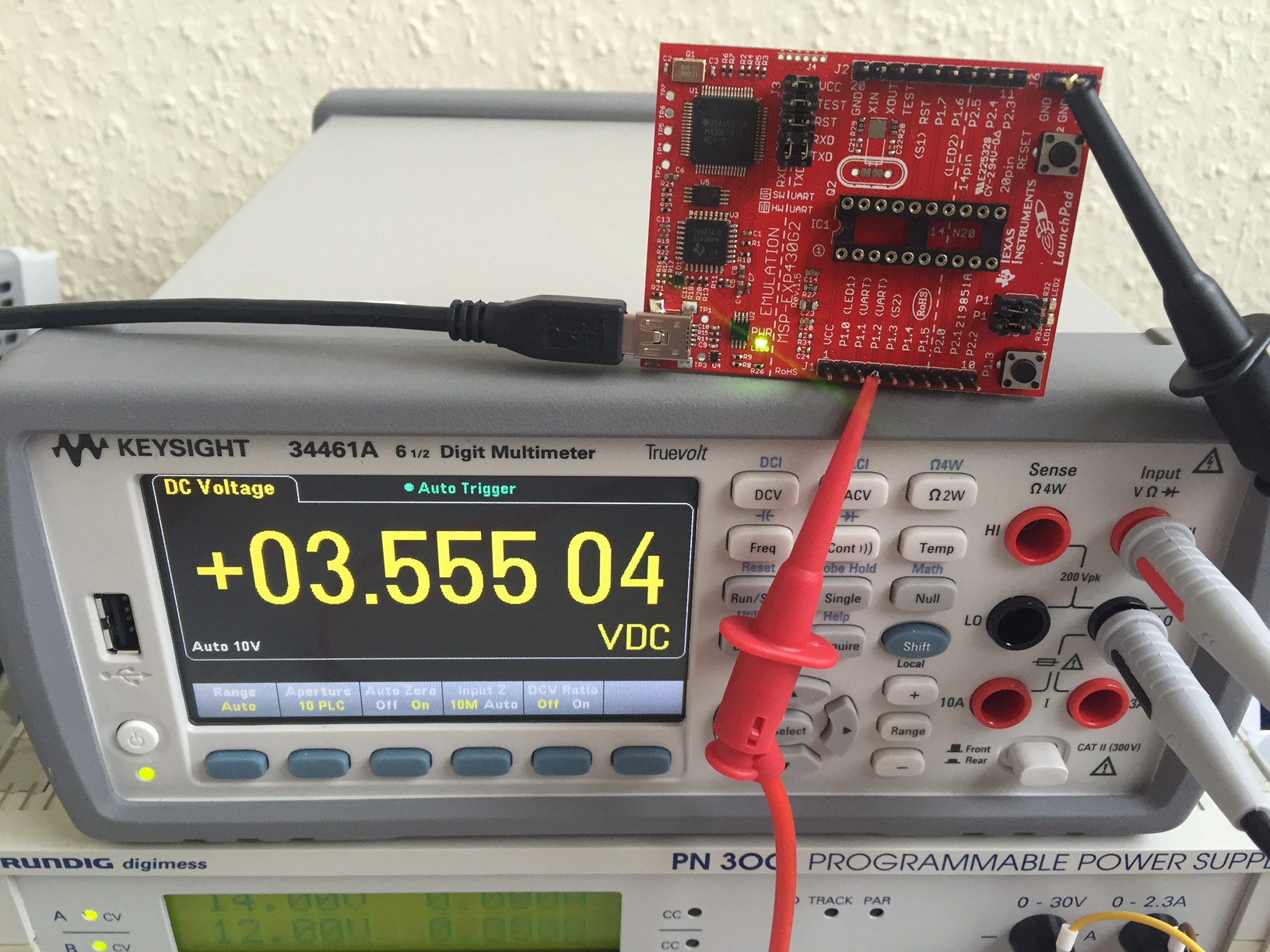

  • I measured it at one of my boards - and as OCY already said, both, TxD and RxD and pulled high by the emulation side of the LaunchPad - there is nothing wrong with your board.
    P1.1:
    P1.2:
    Dennis
  • Jose Rivera45 said:
    when i first purchased it, all jumpers were installed and it never did this
    I guess the board came with the jumpers set to software UART, means 90 degree rotated to the ones in the two pictures I posted. Then you set it to hardware UART.
  • For version 1.5 boards, P1.1 and P1.2 are pulled high whether the jumpers are rotated or not.
    For earlier versions, P1.1 and P1.2 are shorted together the jumpers are rotated.
    You can check the schematics of the board and the firmware inside the MSP430F16xx chip on the board to confirm this.
    Yes, you're right - just had a second look.
