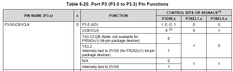

but i am unable to see the clock on my port on oscillator . Can any one help me how to configure a clock for spi in my msp430fr5972 .
Mohammed Shahrukh khan
  • Hi Mohammed!
    When you want to use the SPI function, you have to set the pins to that special function first. P3.0 is UCB1CLK, you already noticed that. But look at the datasheet, page 81:
    The table shows that you have to set P3SEL0 for UCB1CLK. You cleared this bit. Furthermore P3DIR and P3OUT are don't care because the pin is controlled by the USCI module in that case.
    Then you did not configure the USCI module. Look at the code examples to see how this is done. You can download them on the product website for the controller.
    And you maybe misunderstood the function of the pin. It will not continuously output a clock signal - it only outputs a clock signal when a transmission is active. When something is placed into the TX buffer it will start to output a clock signal. But only if the USCI mnodule is configured properly.

  • Thanks Dennis i will correct this out .
  • Hi Dennis Still i am unable to do . I am doing like this .
    P3SEL1 &= ~BIT0;
    P3SEL0 |= BIT0;
    P3SEL1 |= BIT4 | BIT5 | BIT6;
