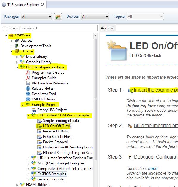

  • Hi Nitesh,
    It sounds like you want to use the USB port on the MSP-TS430PZ100USB board to do some USB CDC communication with your computer. There are a number of USB examples already included in the MSP430 USB Developer's package (MSP430USBDEVPACK), including how to use CDC. There are also several documents included with this on how to develop USB applications. But I would recommend at first trying one of the basic CDC examples - see for example C0_SimpleSend or C3_EchoToHost. By the way, if you allowed MSPware to install when you installed CCS, you should already have all of these examples built into your CCS install - using View > Resource Explorer and then in MSPware going down to Libraries, you can see the MSP430 USB Developer's package, including all documentation and code examples. I hope that this helps get you up and running.
    Katie
  • Thanks Katie,
    Since it is first USB assignment, i found the things are well explained, but as you told in MSPware i am not able to locate USB projects, on clicking Example project it shows TI window of USB Developer Package window. I have already downloaded this package but not seeing that in CCS ->view->Resource Viewer->MSPware.
    Please guide me how to get this.
    Nitesh
  • Hi Nitesh,
    I see what you mean about the navigation issues if you are using the main pane for your navigation - I'll provide this feedback to the team. For now, please use the left hand pane which has a tree/folder structure that you can expand to find your examples. Alternately, try using the Cloud version of Resource Explorer found here: dev.ti.com.
    In Resource Explorer MSPware, try looking under:
    MSPWare > Libraries > USB Developer's Package > Example Projects. Here on the left tree you should select one of the types of USB example projects, e.g. CDC (Virrual COM Port) Examples, then select one of the examples, e.g. Echo Back to Host. All of this navigation is being done on the tree structure on the left pane. Here is an image:
    Hope this helps. Here also is a link to the same place in the Cloud version of TI Resource Explorer: http://dev.ti.com/tirex/#/?link=MSPWare%2FLibraries%2FUSB%20Developers%20Package%2FExamples%2FCDC%20(Virtual%20COM%20Port)%20Examples%2FEcho%20Back%20to%20Host
    Katie
