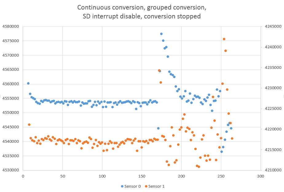

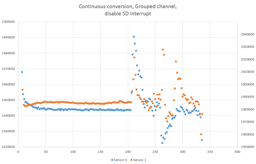

I have a problem using MSP430i2041 in continuous mode. I am using the 4 SD channel with infrared sensor. I want to do 4 conversion, mean them, stop conversion during ~250ms using watchdog timer and after those 250 ms start again 4 conversion. Therefore, I want to start 4 conversion every 250ms. The problem is if I stop conversion using SD24CCTL0 &= ~SD24SC after the 4 conversions were done, it gives less accurate value than using disable interrupt without stopping conversion. When using disable interrupt it consumes much more power than when using stop conversion because conversion continue when the MSP is in sleep mode.
Why the result are less accurate using stop conversion? Is it possible to have a better accuracy? And why digital result have another mean value in term of all result compare with disabling interrupt?
Attach there is 2 graph that show result using stop conversion or disable interrupt, to show the accuracy the first  ~200 values are when there is no movement and the following one are when there is movement. When there is no movement, the difference between 2 following value should be low and when there is movement the different should be higher. (the x axis is the conversion number and the y axis is the value of the adc. when there is 2  axis the one on the left is for sensor 0 and on the right sensor 1.

    I discover the reason why the mean value obtain when only interruption is disable (ID) is different from when stopping conversion (SC). In fact using SC the voltage at the A1-, A2- etc change according to the gain (when the gain is 2 it multiply the voltage of the Ax- by 2 compare to gain 1) and when only ID is used the voltage of the Ax- is constant. Here I used the same gain for both way but even with that the voltage is different using ID or SC. I still don't know why it does that.
    I suppose that the difference of accuracy of the results in the 2 way can also be due to that.
    If you have an explanation of those differences, I am still interested to know more.

    As Katie said before, sorry for the delay in response. I am just now catching up following the holiday.
    My first thought when encountering this post is that some difference should be expected, due to the nature of delta-sigma converters and their continuous nature. As you probably know, the delta-sigma architecture is built on oversampling of data, and using this extra "context" to drive a control loop like circuit to achieve high resolution on low frequency signals.
    That being said, the difference should not be this extreme. You had stated that you took data where both signals were at the same gain, do you have similar plots to share for this updated data?
    Another thing I noticed quickly looking through your code is that you are entering LPM3 in your main loop, but then waking up and re-entering LMP0 in your ISRs. Is this intentional, or is this a mistake?
    A second thing to try in your code is to simply change your converters over to single conversions rather than continuous and starting/stopping interrupts with the interrupt enable. In actuality, it looks like your code doesn't actually stop the conversions, just the interrupts from the conversions, and the extra start conditions (although they shouldn't) could be causing a bit of unexpected noise in the input circuitry. Have you already attempted the same code, but using just a single conversion?
    I would suggest that you fix the two issues I mention in your code and test it again. Please let me know if this continues to be an issue.

    Data shown on my first post are both at the same gain (gain 1).
    For the LPM mode I want to pass from LPM0 to LPM3 without waking up the device completely, but I am not sure I am doing it right. In fact I correct at the end of LPM0 ISR I directly go into LPM3 instead of “bic… lpm0”.
    You were right for the extra starting instruction. It was the cause of the multiplication of the minus input. Without the extra start, the minus input is at the same voltage as the continuous conversion using stop conversion or single conversion.
    Finding that, in continuous conversion with disable interrupt and the extra start, I have the voltage changing I found that my dimensioning of my low pass filter R2 and C2 was not so well dimensioned because the differential offset was too high.
    I did try the single conversion. You can find attached the results using all possible configurations and my code for each of them. On the results the A0 is with the new dimensioning of the minus input low pass filter and A1 with the old one. The continuous conversion using interrupt disable are both (A0, A1) with new dimension for R2 and C2. The continuous conversion, not grouped with mean value doesn’t show very good result. I used another code because with this one I had only 0 result in log break point on IAR but when I use simple break point I can see the value wants is not 0. I will not use this configuration therefore it is not very important.
    Now I have more or less the same result for each configuration, I still have problem of coupling. In the attached file (single conversion, coupling test) showing difference value of 2 following value, you can see that when I move in front of another PIR sensor the other sensor have higher voltage. I don’t know if it is a problem of the circuit or if it is due of the microcontroller coding. When I use “not grouped” configuration it is less visible compare to group conversion. Do you know if it could be caused by the microcontroller?
