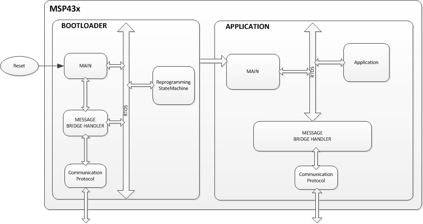

    It seems to me that you will need to implement a "custom" BSL or a Boot Loader (MSPBoot) and there are a few ways that you can accomplish this, you may want to take a look at this http://processors.wiki.ti.com/index.php/Custom_MSP430_BSL this is for a MSP430, but you could also apply it to a MSP432
     Please keep in mind that the custom BSL size needs to be less than 8KB (fixed space reserved in the MSP432), so the size of your wireless stack may dictate the path that you will need to follow (custom BSL or a boot loader). For a boot loader you will need to partition your memory map, for example 16KB for your boot loader and 240KB for your application and the architecture should look something like this:
    Hopefully this makes some sense.
