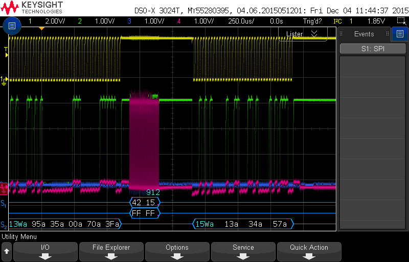

    Below is a screen capture of what should be seen from the SPI. The packet that is beeing sent is 114 bytes long and results in 912 SPI clocks.

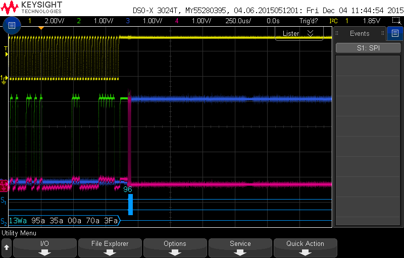

    The picture below shows what happens when it goes wrong. In this case the SPI only runs for 96 clocks or 12 bytes. This results in the DMA interrupt not happening screwing up the code later.
