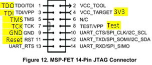

    However I can not make it work with SmartRF Flash software, when I click the "Refresh" button nothing happen, the software does not see the MSP430.
    What is wrong with SmartRF?
    Here is the connection between TI_MSPFET and the MCU. (use 8 wires)
