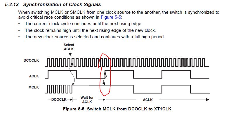

    I raise the question 1 year ago referred to the case that while switching the MCLK from internal osc to external osc in which I found the XT1HFOFFG flag will be set and last 1.25ms even though the external oscillator has been stable. I review it today and have a doubt that is it necessary to clear the XT1HFOFFG while switching the MCLK clock? I mean, should I switch the MCLK to external osc immediately without waiting for the XT1HFOFFG is clear because the external osc is already stable.
    Also, I'm not clear for the setting of XT1HFOFFG in this case. In my opinion the XT1HFOFFG is set just for clock synchronization as showed below in user's guide, am I right?
  • Clock synchronization happens only when the new clock is valid, i.e., only when the fault counter has expired.
    As long as you do not clear XT1HFOFFG, the new clock source will not actually be used.
