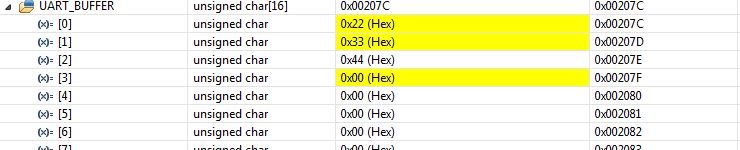

I try to receive some data through UART module under MSP430FR6989
the baud rate is 19200 and the clock source from SMCLK 4Mhz
the issue is that I am missing data during the transfer process when using interrupt methods
the data I was trying to send
the actual data I am getting, 1st time its correct
2nd time there is a missmatch
3rd time
any reason could cause this issue?  I double checked my baud rate setting and it seems correct.
