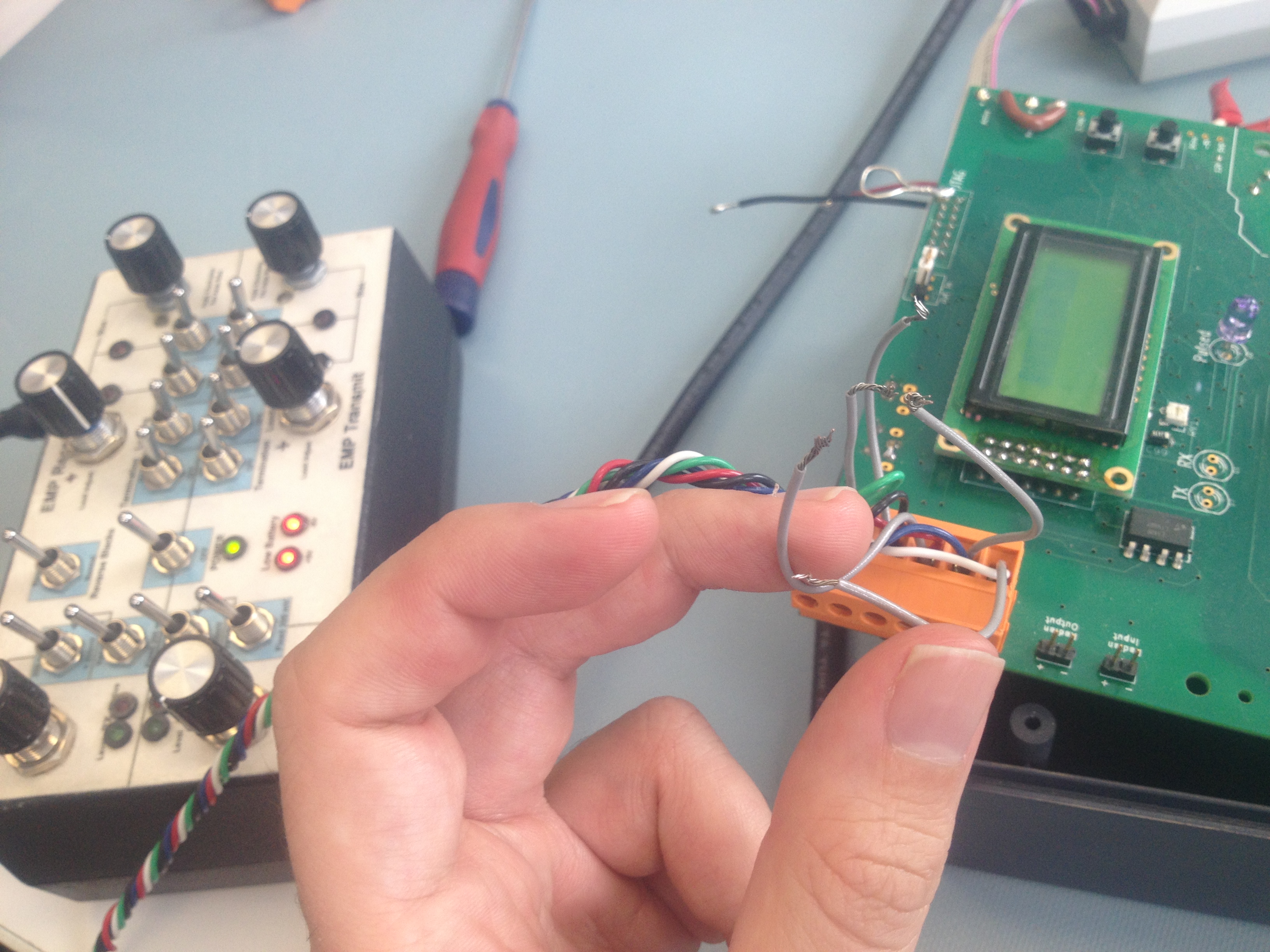

    Thanks for your reply, I did the following changes. And like the previous time I have nothing. However, when I use my other device which has Loop back + battery power, sometimes I receive garbage!!! such as A with two dots on top and Y with two dots on top! (extended Ascii chart)
    I believe that I do not have enough time to grab what I have sent through TX!
    As you said my Simple loop back has only TX(+ to +) and RX(- to -) but in the battery powered the ground which is pin 5 is also considered!
    That's why you talk about resistors and biasing! I guess the bias is now OK but my buffer is getting garbage!

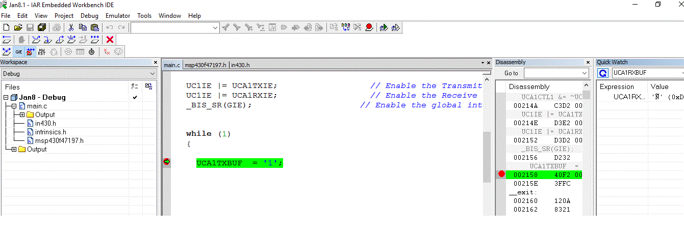

    I changed the code to the following and with playing the wire ( figure) I get those garbage!
    #include "msp430f47197.h"
    int y;
    void main(void)
       WDTCTL = WDTPW + WDTHOLD; // Stop the Watch dog
       P1SEL  |=  BIT6 + BIT7;  // P1.1 UCA1RXD/TXD input
       UCA1CTL1 |=  UCSSEL_2 + UCSWRST;  // USCI Clock = SMCLK,USCI_A0 disabled
       UCA1BR0   =  104;                 // 104 From datasheet table-
       UCA1BR1   =  0;                   // -selects baudrate =9600,clk = SMCLK
       UCA1MCTL  =  UCBRS_1;             // Modulation value = 1 from datasheet
       UCA1CTL1 &= ~UCSWRST;             // Clear UCSWRST to enable USCI_A0
      //---------------- Enabling the interrupts ------------------//
       UC1IE |= UCA1TXIE;                  // Enable the Transmit interrupt
       UC1IE |= UCA1RXIE;                  // Enable the Receive  interrupt
       _BIS_SR(GIE);                     // Enable the global interrupt
       while (1)
         UCA1TXBUF  = '1';
      //                Transmit and Receive interrupts                        //
      #pragma vector = USCIAB1RX_VECTOR
      __interrupt void ReceiveInterrupt(void)
        UC1IFG &= ~UCA1RXIFG; // Clear RX flag
       if (UCA1RXBUF == '1')
         y++;
  • Getting garbage usually is a sign of a wrong baudrate. But in your case, TX and RX baudrate are always the same. Another possible reason could be a disabled transmitter and missing biasing resistors. So the RX side is just receiving noise from EMI, which sometimes seems to be a valid UART byte frame.
    Biasing resistors are a pull-up of the + line to VCC and the - line to GND, so if no transmitter is on, the line is in a defined state and not floating.
    Also, a shorting resistor between the two line eiminates echoes. In our RS485, we have 1k to VCC and GND and 470R between the lines. That means, when no transmitter is on, the A line is on 3V and the B line on 2V, giving a comfortable 1V signal difference (0.2V is the usual threshold) while shorting all EMI.
    When you send form PC to the device, the PC transmitter is on and you receive valid data.
    Did you ever receive anything on the PC from the MSP?
