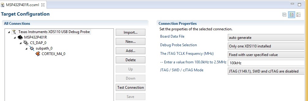

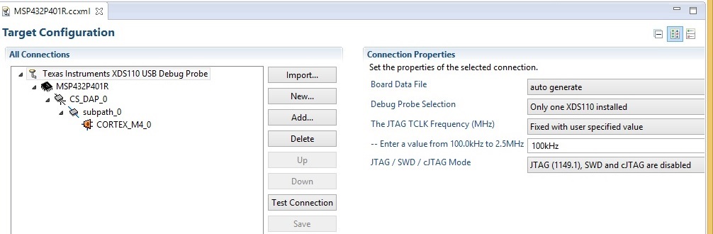

  • A minor update:
    I tired several solutions from other similar threads, including lowering the JTAG clock down to 100kHz, as well as switching to SWD Mode.
    AT 100KHz

    Switch from "JTAG (1149.1), SWD and cJTAG are disabled" to "SWD Mode - Aux COM port is target UART port"

    I then again hit Debug in the Blink Project
    CORTEX_M4_0: GEL Output: Memory Map Initialization Complete
    CORTEX_M4_0: GEL Output: Halting Watchdog Timer
    CORTEX_M4_0: Flash Programmer: Verbose output enabled
    CORTEX_M4_0: Flash Programmer: DLL Version 0.9.6.0
    CORTEX_M4_0: Flash Programmer: Hard reset
    CORTEX_M4_0: Writing Flash @ Address 0x00000000 of Length 0x00000fc8
    CORTEX_M4_0: Flash Programmer: Uploading RAM loader to device
    CORTEX_M4_0: Flash Programmer: Device init finished
    CORTEX_M4_0: Flash Programmer: Erasing main memory
    CORTEX_M4_0: Flash Programmer: Mass erase finished
    CORTEX_M4_0: Flash Programmer: Writing 4040 bytes to flash memory 0x00000000
    CORTEX_M4_0: Flash Programmer: Write speed 2.6 kB/sec
    CORTEX_M4_0: Failed CPU Reset: (Error -2063 @ 0x0) Unable to reset device. Power-cycle the board. If error persists, confirm configuration and/or try more reliable JTAG settings (e.g. lower TCLK). (Emulation package 6.0.83.1)
    CORTEX_M4_0: Trouble Halting Target CPU: (Error -2062 @ 0x0) Unable to halt device. Reset the device, and retry the operation. If error persists, confirm configuration, power-cycle the board, and/or try more reliable JTAG settings (e.g. lower TCLK). (Emulation package 6.0.83.1)
    CORTEX_M4_0: Error occurred during flash operation: CPU Reset failed with error code 1
    CORTEX_M4_0: Error occurred during flash operation: Could not read 0xE004300C: execution state prevented access
    CORTEX_M4_0: Error occurred during flash operation: Could not write 0xE004300C: execution state prevented access
    CORTEX_M4_0: Flash Programmer: Watchdog halt failed
    CORTEX_M4_0: Error occurred during flash operation: Could not read 0x4000480C: execution state prevented access
    I did another Factory_Reset, change the Target Configuration to "SWD Mode - Aux COM port is target TDO pin"
