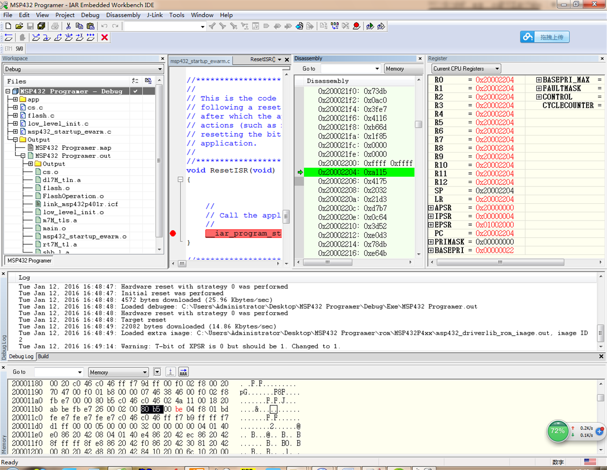

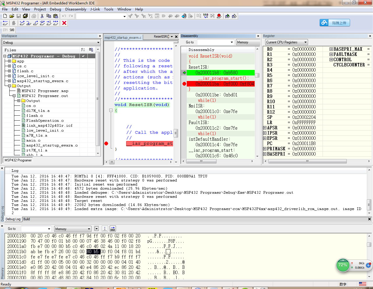

Hi, I want to locate my code to SRAM and  excute in  it , i have changed the icf file as below:
so i want to store my code to 0x20000000-0x20001FFF,and using 0x20002000-0x20003FFF  for data(real RAM)
 After doing that the runtine do not excuted as expecte,why this happened?
so i want to ask TI's employee, whether we can do it or not?
or is there any other methods to realize it ?
1、start debugger
2、sigle step   error ocurrs

    In your case you may just need to modify your linker file to use the Code Zone area:
    from:
    define symbol __ICFEDIT_region_ROM_start__ = 0x20000000;
    define symbol __ICFEDIT_region_ROM_end__ = 0x20001FFF;
    to:
    define symbol __ICFEDIT_region_ROM_start__ = 0x01000000;
    define symbol __ICFEDIT_region_ROM_end__ = 0x01001FFF;
    Please give this a try and let me know if you have further questions.

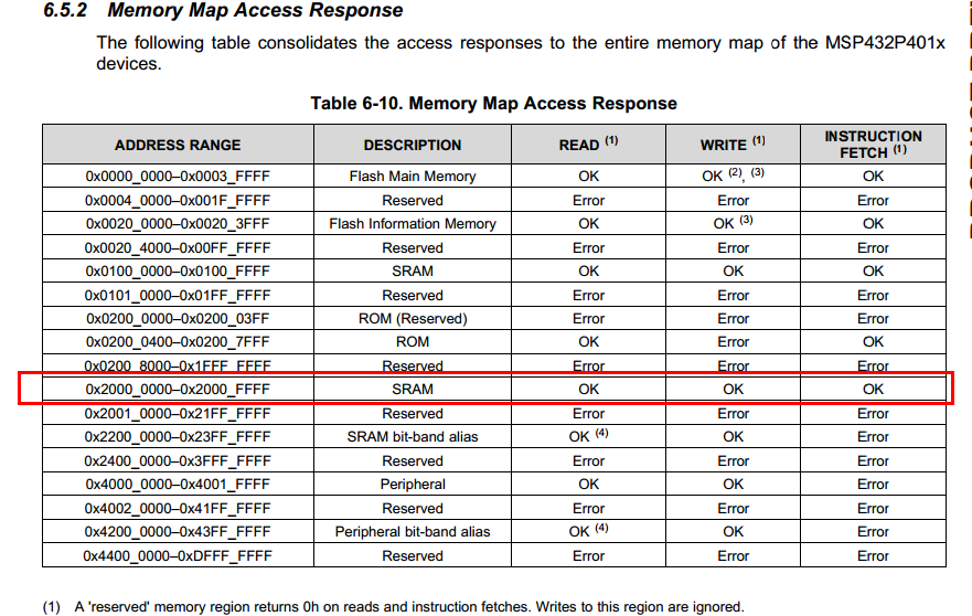

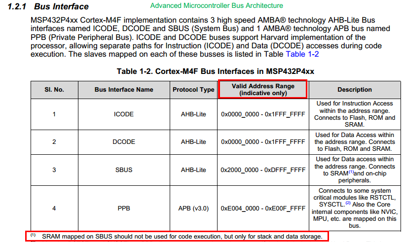

    and i have some more question about MSP432
    1 it seems that msp432 have two blocks SRAM,one from 0x01000000-0x0100FFFF(64KB),the other is from 0x20000000(64KB),  the user guid says that 0x2000 0000 can not be used for instruction fection,so it can not be used to store code
    but the user guid says it 0x20000000-0x2000FFFF can be used for instruction fetch

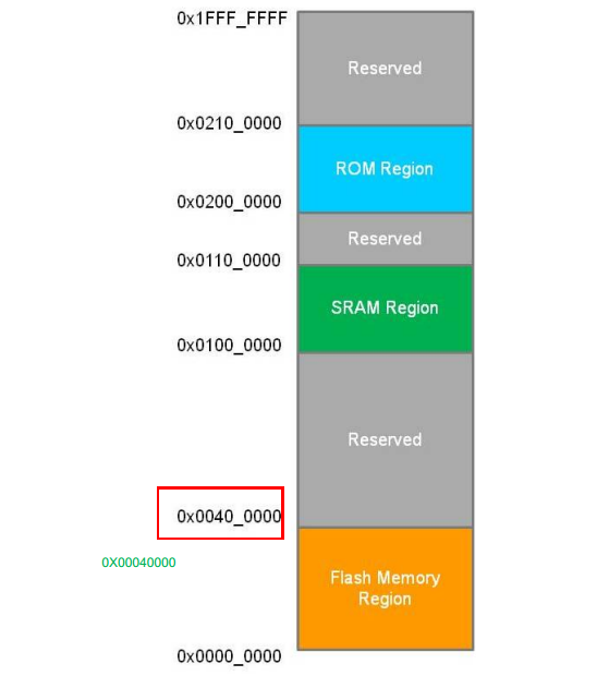

    3、and there may be a small mistaken in datasheet, MSP432P401x's flash is 256KB,so the address should be 0x00004000 not 0x00400000

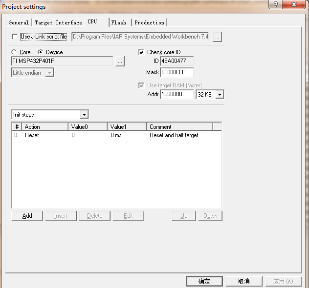

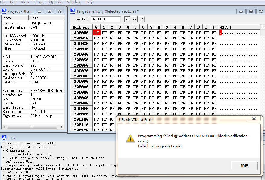

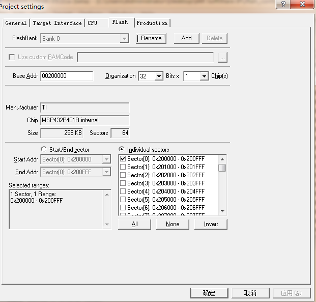

  • i used jlink to program flash sectors and information sectors
    my jlink software is J-Link V5.11a from segger website
    and here is my problem:
    1、program and erase flash sector is OK
    2、erase information sector is OK, but program information sector have problems:

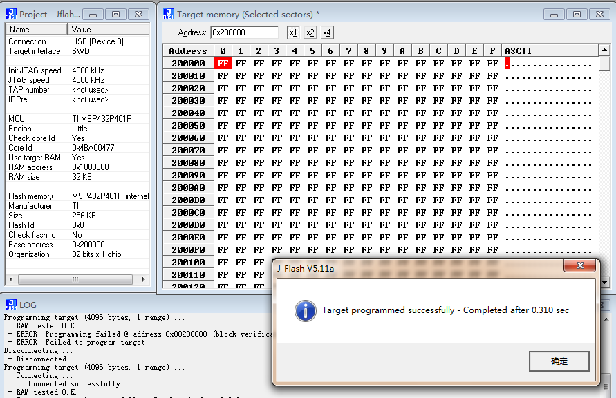

    but when i changed the data at 0x00200000 to FF,it can be programed
    my j-flash project settings  just  as  below:
    why this happened ?
    is there any other tool that i can directly program information sectors?
  • Hi Kissn Liu,
    It is the same block. The SRAM memory is aliased in both Code as well as SRAM memory zones. This enables fast, single cycle execution of code from the SRAM, as the Cortex-M4 processor pipelines instruction fetches to memory zones other than the Code space.
    This needs to get corrected in the user's guide

  • Hi Kissn Liu,
    Let me look into this, because I'm not that familiar with that tool.
    In the meantime you can use IAR to program the Info section. Please take a look at the section "Erasing the Bootstrap Loader" in this document www.ti.com/.../slau574
    David
