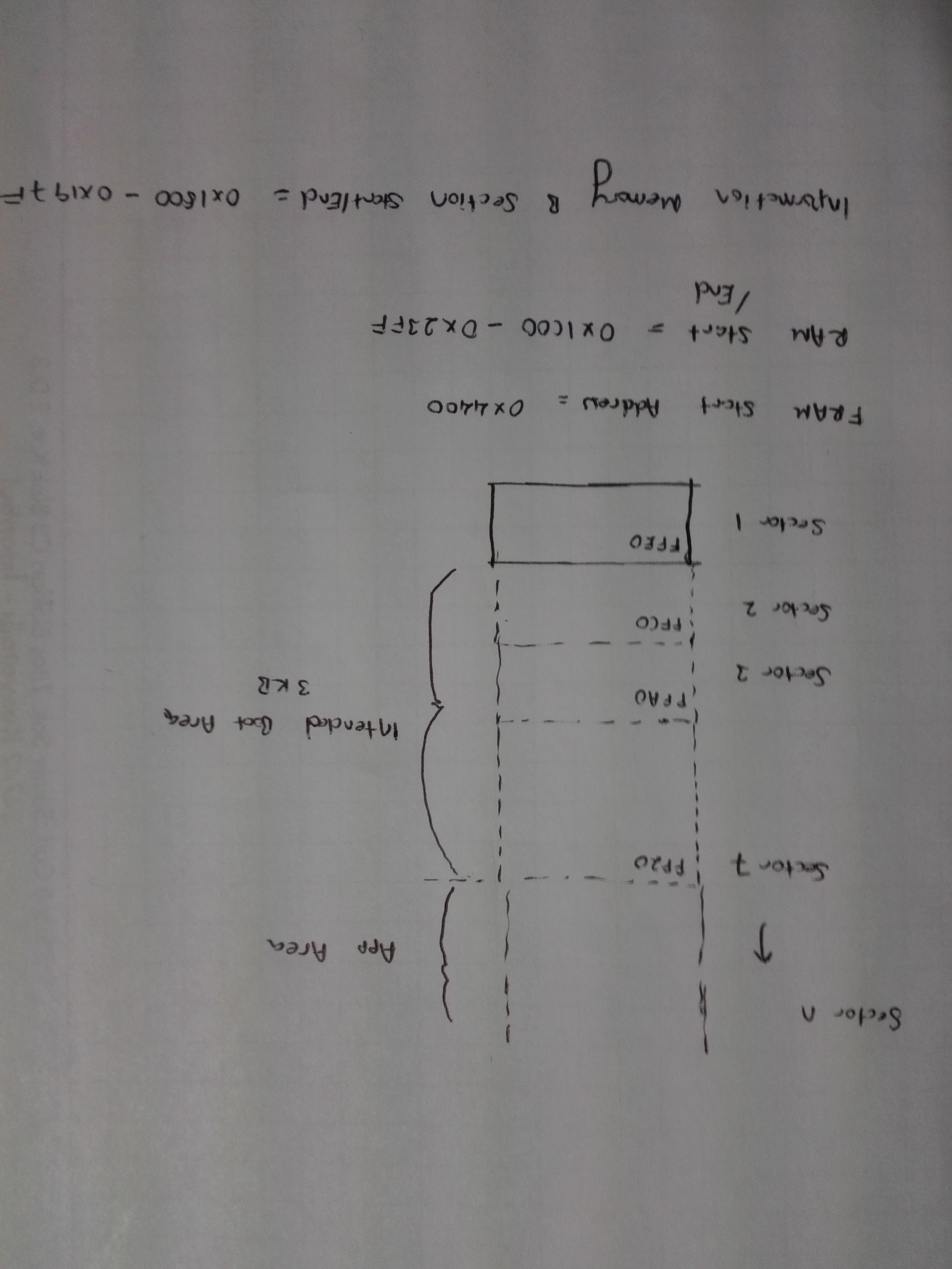

  • Hi David,
    I have tried to run small test sofware using the linker file generated by MSPBootLinkerGen but i got an error on the IAR message section as
    Fatal Error[e72]: Segment DATA must be defined in a segment definition option (-Z, -b or -P).
    This error has disappeared when i put the following defination as below in  read/write memory section
    -Z(DATA)DATA20_I,DATA20_Z,DATA20_N,DATA20_ID,DATA20_C
    -Z(DATA)DATA20_HEAP+_DATA20_HEAP_SIZE
    but i don't see any instruction in  fram and another memory  sections when the code is debuged (I'm sharing iar screenshot in attached) .Also  the linker file was created according to below parameters.
    " perl MSPBootLinkerGen.pl -file lnk_msp430fr6972_3kb -dev MSP430FR6972 -params 0x4400 0xFFE0 0xFF20 48 4 0x1C00 0x23FF 0x160 0x1800 0x197F "  and i'm sharing  my memory map as attached.
    Do you have any idea to resolve this problem? How can i create a linker file successfully?
