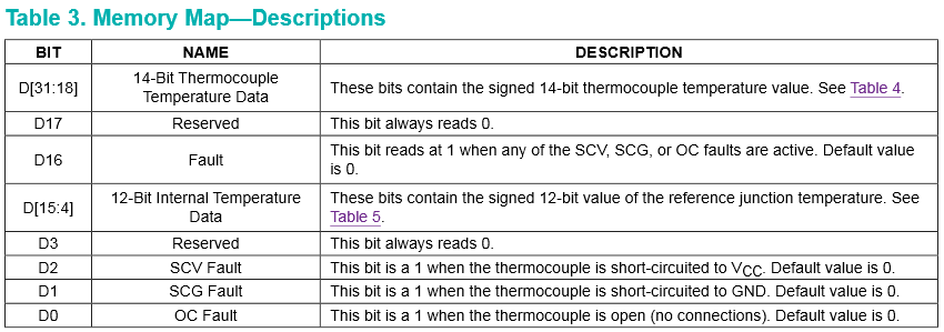

  • Once you have your 32 bits of received data, you simply have to mask the different information in it - here is the table from the datasheet:
    The 32 bits contain 14 bits of thermocouple temperature data, 12 bits of reference junction temperature data, 4 status bits and 2 bits that are always zero.
