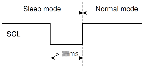

  • Hi TI employees,
    I like to know is it true that I could use MSP430 USCI_Bx to generate the attached image master SCL clock stretching signal (1.3.5.1 Clock Stretching) with a delay function to cancel a slave device from sleep ?
  • It seems that your slave goes into sleep and wakes up if a clock low of sufficient length is detected.
    If so, you can generate the LOW pulse by simply switching the SCL pin to I/O mode (configured for low output) and back, without any fancy USCI tricks.
    However, I don't remember such a sleep/wakeup to be part of the I2C specification, so more details are required.
    To answer your question literally: yes, you could. After all, generating a clock pulse depending on clock speed is one of the main functions of the USCI I2C hardware. Whether it is useful four your problem is another question. :)

  • One thing to add: the 'clock stretching' feature is meant to enlarge a clock pulse depending on events. Like waiting for you to write something to TXBUF before the transmission can proceed, or waiting for you to read the last received byte from RXBUF so it isn't overwritten by the next incoming byte.
    It cannot be used to deliberately generating a clock pulse of a desired length. Even though you of course can use a timer to time the _end_ of a clock stretching situation, you cannot _start_ it at will. It will only happen at certain situations. Situations in which you can't make use of it for your purpose.
