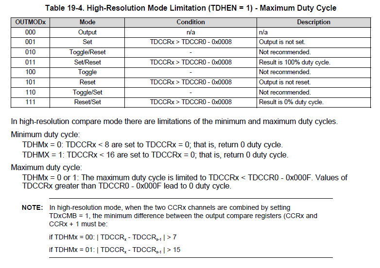

    From the TRM you can find limitations of the CC values for maximum duty cycle:
    I'm not sure if I can push this any further to try to get a narrower pulse width but it would be nice to see what you can get under the right conditions

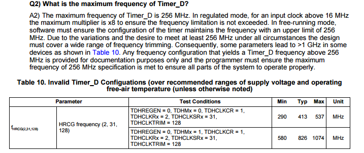

  • Hi George,
    Can you please elaborate on what you are trying to accomplish? If I understand correctly, you want to test the absolute maximum PWM frequency that you can generate with Timer_D. If this is the case, the maximum PWM frequency is 16MHz. In the document Ryan suggested above (SLAA601) there is a note regarding the maximum frequency of Timer_D operation:
    The only way you can accomplish a PWM frequency higher than 16MHz is by running Timer_D outside the recommended operating conditions. I looked at your code and you are in fact running faster by adjusting the TD0HCTL1 register.
    MSP430 microcontrollers are designed, characterized and tested to run within the specifications outlined in the respective datasheets. Operating above Recommended Maximum values or below recommended minimum values in general could lead to unexpected results; operating above Absolute Maximum values or below absolute minimum values in the datasheet can cause physical damage to the MSP430 MCU.
    It is true that in some use-cases an MSP430 MCU may operate correctly outside of the specified limits, but performance is not guaranteed and such operations are done at the risk of the user.
    Regarding your note about using CALTDH0CTL1_256 for TD0HCTL1. CALTDH0CLT1_256 is not a constant because it is not the same for all devices. CALTDH0CLT1_256 points to a memory location in the TLV structure in memory that contains device-specific calibration constants. The TLV structure contains calibration values that can be used to improve the measurement capability of various functions. The calibration values available on a given device are shown in the TLV structure of the device-specific data sheet. This is also explained on SLAA601:
    I hope this helps,
    Damian

  • Ilmars,
    There are two different frequencies: 1) the frequency of Timer_D and the 2) PWM frequency. SLAA601 explains why the maximum frequency of the PWM is not the same as the maximum frequency of Timer_D (or even why it cannot be 25MHz). The maximum frequency of Timer_D is 256MHz, but the maximum frequency of the PWM that can be generated using Timer_D as the input source clock is 16MHz.
    Damian

    While I have your attention, why in Table 10 do they have TDHCLKTRIM = 128 when TDHCLKTRIM is only 7 bits in the register and therefor can't be more than 127, setting it to 128 takes 8 bits?
    George

  • George,
    I am not sure why the value is 128. If I had to guess, I would say that this includes the reserved bit 0 of the TDxHCTL1 register. I sent the question to the folks that maintain datasheets, so hopefully I will have a better answer for you then.
    To elaborate further on CALTDH0CTL1_256, the reason that this is a pointer and not a constant is that the actual value that gets loaded into TD0HCTL1 varies slightly from device to device. TI runs a calibration routine before shipping units that populate the TLV table (a region of non-volatile memory) with the calibration values for each specific device. So, if you do TD0HCTL1 = CALTDH0CTL1_256 for two MSP430F5172 devices, you are very likely to see different values loaded to the register.
    Damian

  • George,
    The correct value of TD0HCTL1 for the TRIMx bits is 127. The datasheet needs to be fixed.
    Damian
