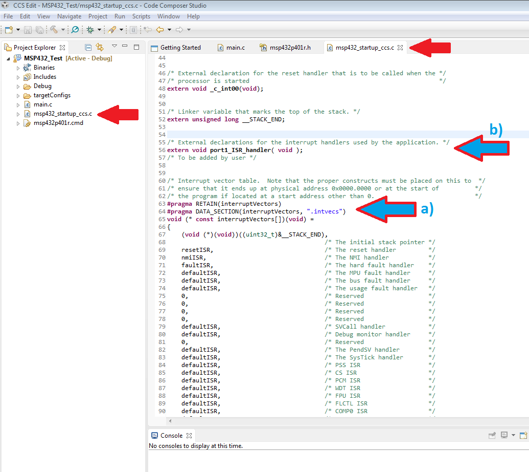

  • Josue Pareja said:
    Also I dont really understand for what I use [...]
    Then first you should understand this. The MSP432 has a different way of handling interrupts. When creating a new MSP432 project, a file is generated that is named:
    msp432_startup_ccs.c
    In this file you add your interrupt functions. You can name your function as you like - I called the interrupt function for the code example
    void port1_ISR_handler( void )
    and you find it under the main() function. The startup file contains a table with all the possible interrupts. You now have to tell, which function shall be executed for which interrupt. So you have to add the function's name a) in the interrupt vector table and b) in the external declarations with adding an extern attribute to the function because it resides in another function (your main.c in that case).
    Here is a picture:
    The red arrows mark the startup file. You open it by double-clikcing on the file in the project explorer located on the left (like for any other file of your project). The blue arrows show the two places where you have to make the changes (the last picture shows the same interrupt vector table as the one before, but scrolled down to the entry of PORT1 ISR where you have to insert your function).
    Dennis
