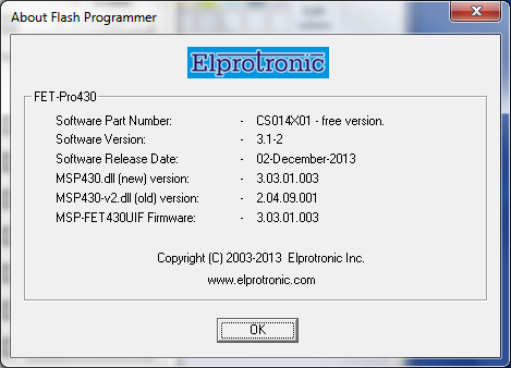

    Here is the information reported in About/Help -> About Software

  • I uninstalled Fet-Pro430 v3.4 and installed version 3.1-2 on the non-working station to make the software on both the same.
    I'm still getting the same error.
    Here is About Software screen on the non-working station, now:
    I'm attempting to communicate with a MSP430BT5190 using JTAG.
