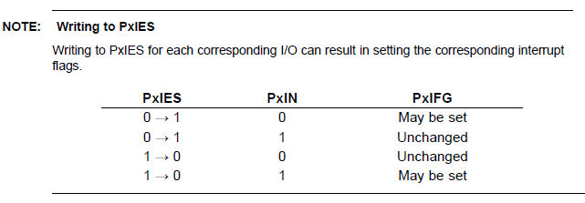

    And I would change the order of your statements here:
    P3IFG = 0;
    P3IE  = IR_BIT;
    P3IES = IR_BIT;
    In general, I would always do the following sequence:
    P3IES = IR_BIT;
    P3IFG = 0;
    P3IE  = IR_BIT;
    Enabling the interrupt is the last thing you do, but right before you should clear any pending flags and every other stuff should be done previously. The reason for this: Changing PxIES can set the flag, look here:
    This does not mean that changing PxIES will necessarily set PxIFG, but it could. Anyway - this is more a general thing and my personal opinion.
