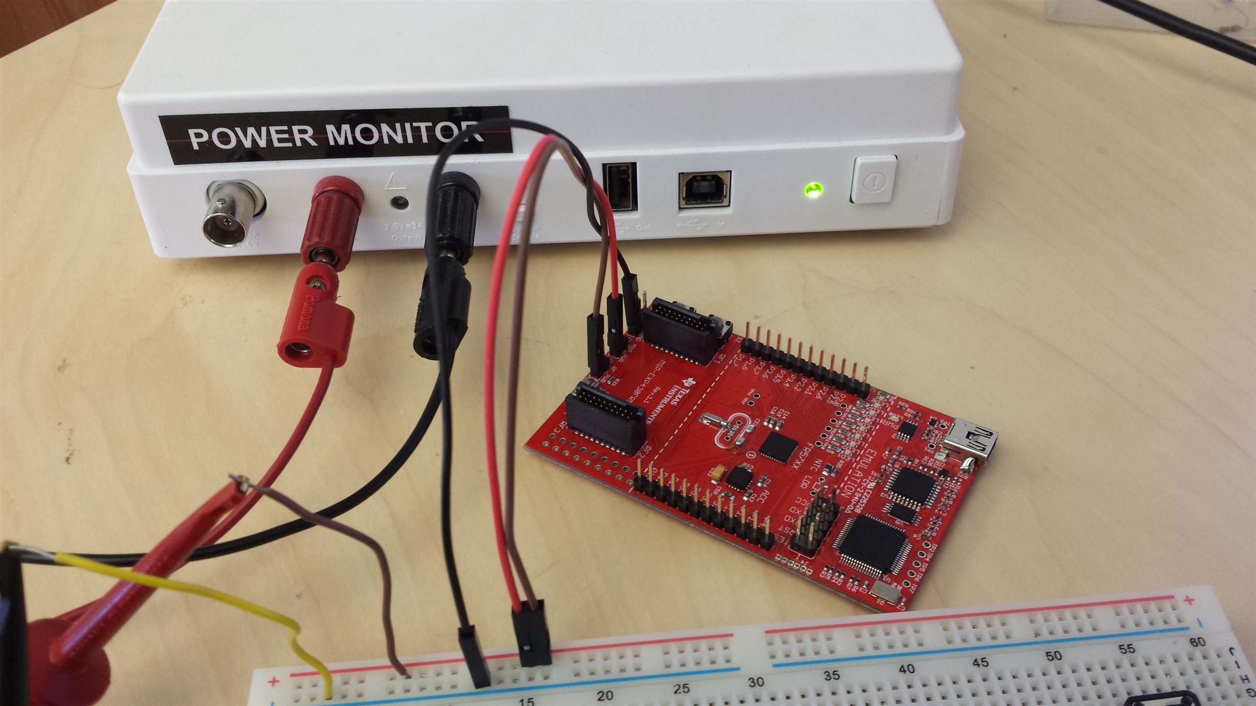

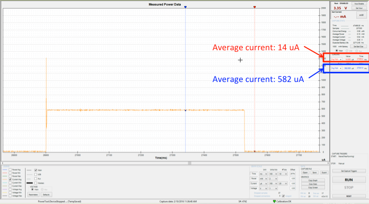

I have been trying to induce the MSP-EXP430FR5739 to enter in LPM4.5 mode. After measuring current consumption with a power monitor (from Monsoon Solutions Inc.) (see Figure 1), I cannot obtain the same current consumption values that are indicated in the device datasheet. On average, these are of the order of 8-14 uA (as seen in the Figure 2).
Figure 1:
Figure 2:
I have followed the user's guide (e.g., section 8.8.3 to enter LPMx.5 modes), but I am not sure of what I am doing wrong any more. At the beginning I though it was a problem of the power monitor and its resolution, but I've seen it can measure values of the order of 0.35 uA (current consumption value for LMP4.5 according to the device datasheet.

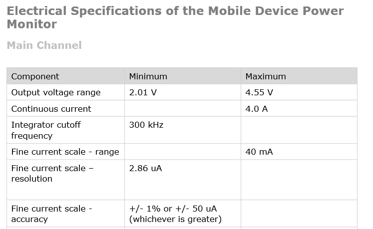

  • Hi David,
    I checked the datasheet of the power monitor you are using. I am afraid, it is not a suitable instrument for the currents you want to measure. The FR5739 has a typical current consumption of 0.32uA in LPM4.5
    The power monitor has a resolution of 2.86 uA and an accuracy of +/- 1% or +/- 50 uA (whichever is greater).
    Thanks and best regards,
    Christoph
