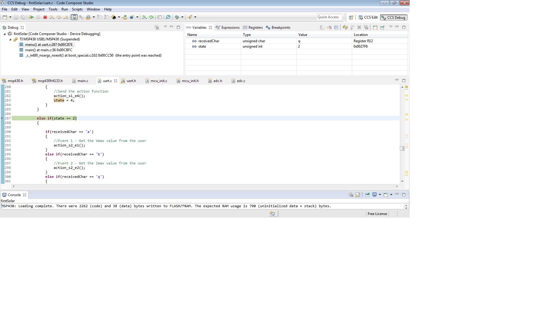

  • I am sending two screenshots as attachment to show what problem I am getting.
    First screenshot - First iteration when the code enters (state == 1) and changes value of state = 2;
    Second screenshot - Second iteration the code enters (state == 2) and returns abruptly to main 'if' loop, without entering the else if loop.
    The variables with their values and locations can be seen in the top right corner. I hope if that helps in answering the question.

  • Hi Rohan!
    Are you using the MSP-EXP430FR4133 LaunchPad? If so - would you share your complete project to test it?
    Dennis
