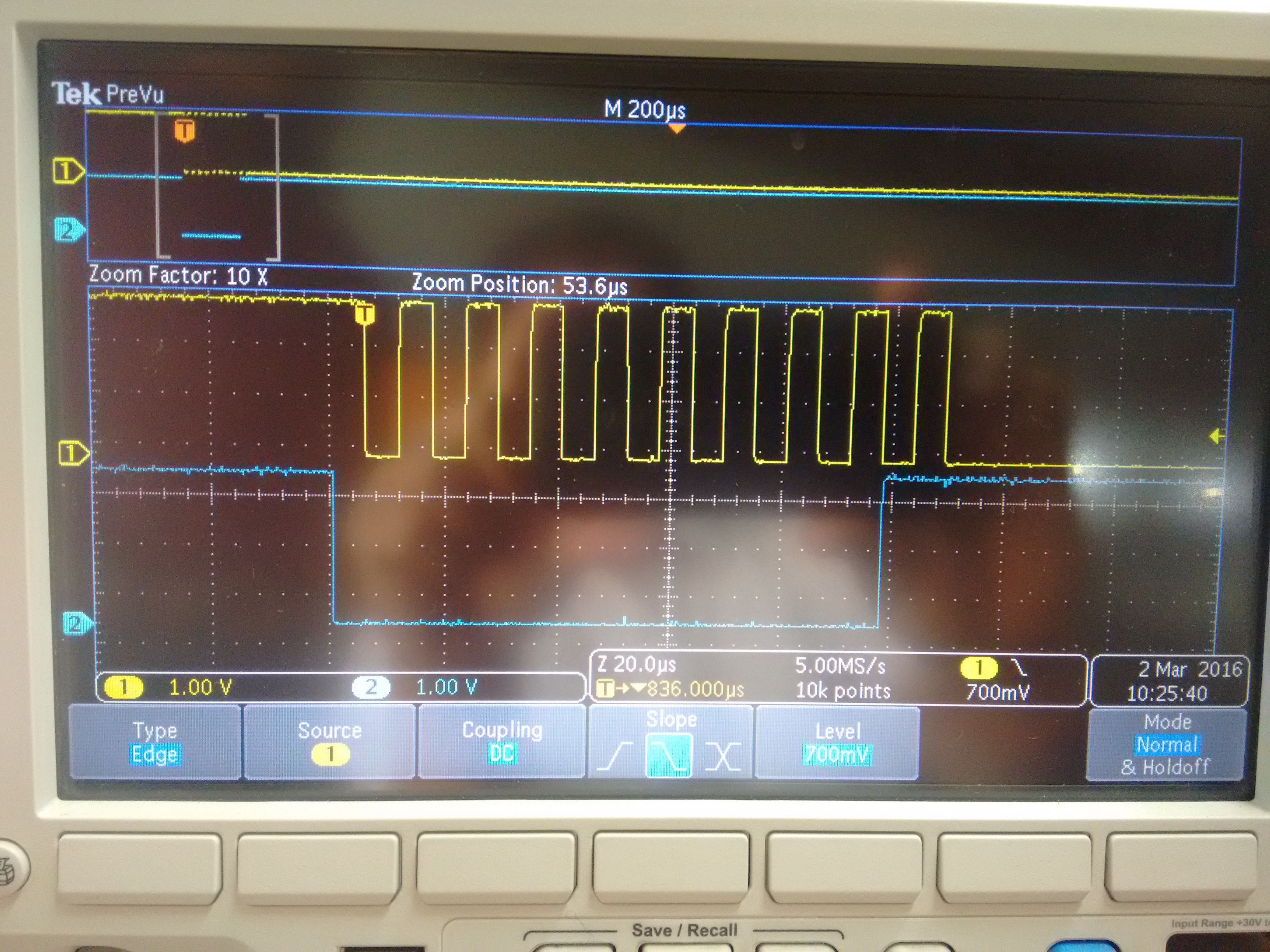

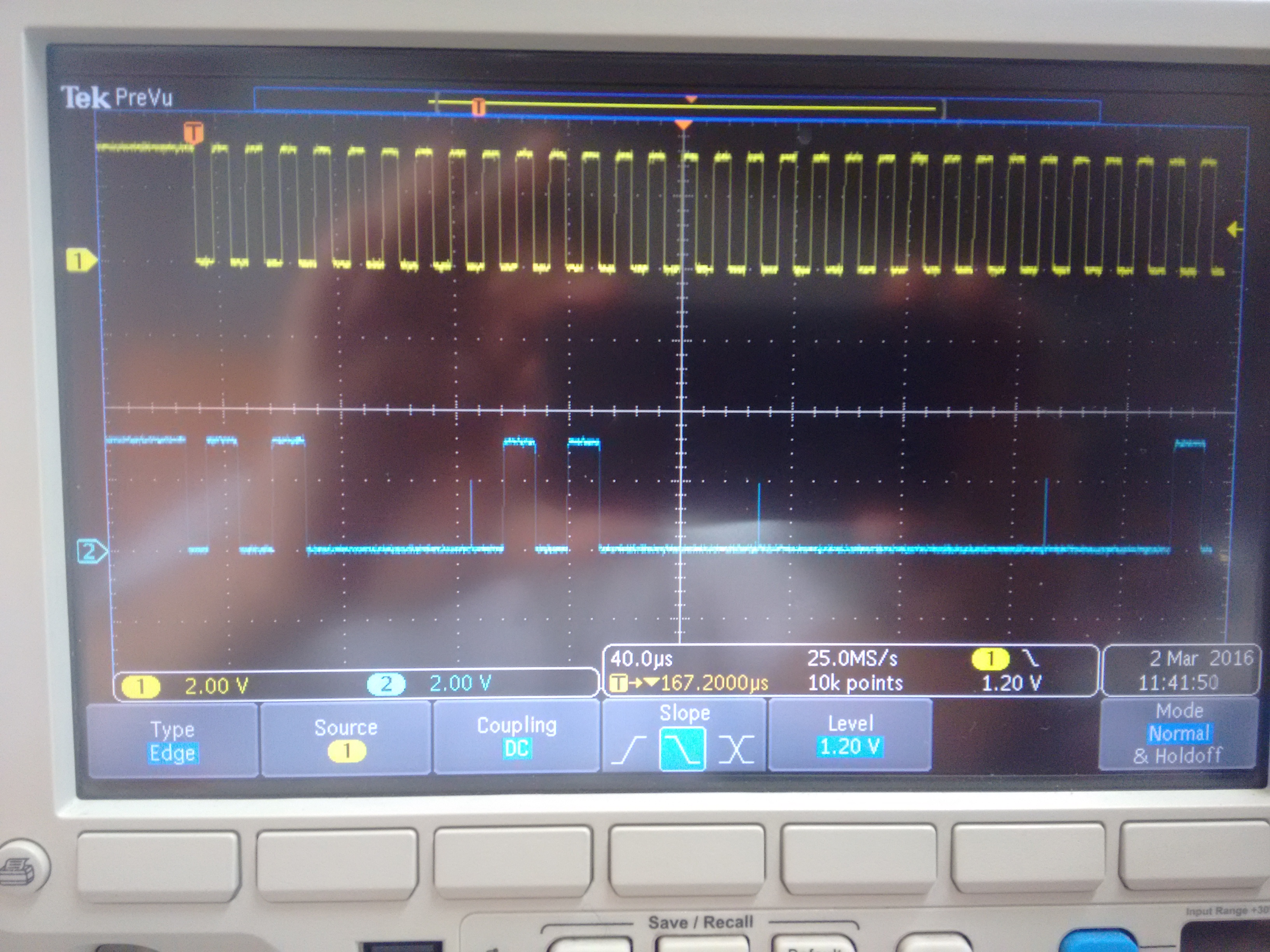

  • Please look into attached waveform where blue line shows clock and yellow line shows data. this is come only once.
    Please guide.
    No one from TI has idea for solution. I have Pull-up data and clock pin of I2C. all other configuration and code is in previous post.
    Bhavdipsinh

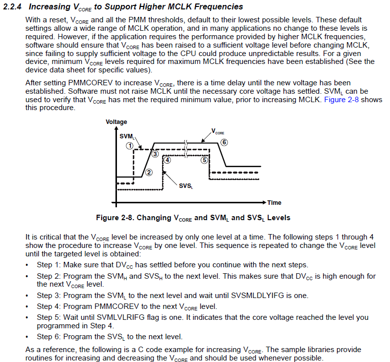

  • Hi Bhavdipsinh,
    the first issue I see already in the init procedure of the PMM
    PMMCTL0_H = 0xA5;
    PMMCTL0_L = 0x03;
    This is not according the user's guide of setting Vcore up to level 3.
    Doing this like you did it is not ensured that code execution will work as expected! Please use the procedure described in user's guide or even better use the DriverLib which you can download from TI web
    If you have corrected it and the issue still appears please let me know.
    Dietmar

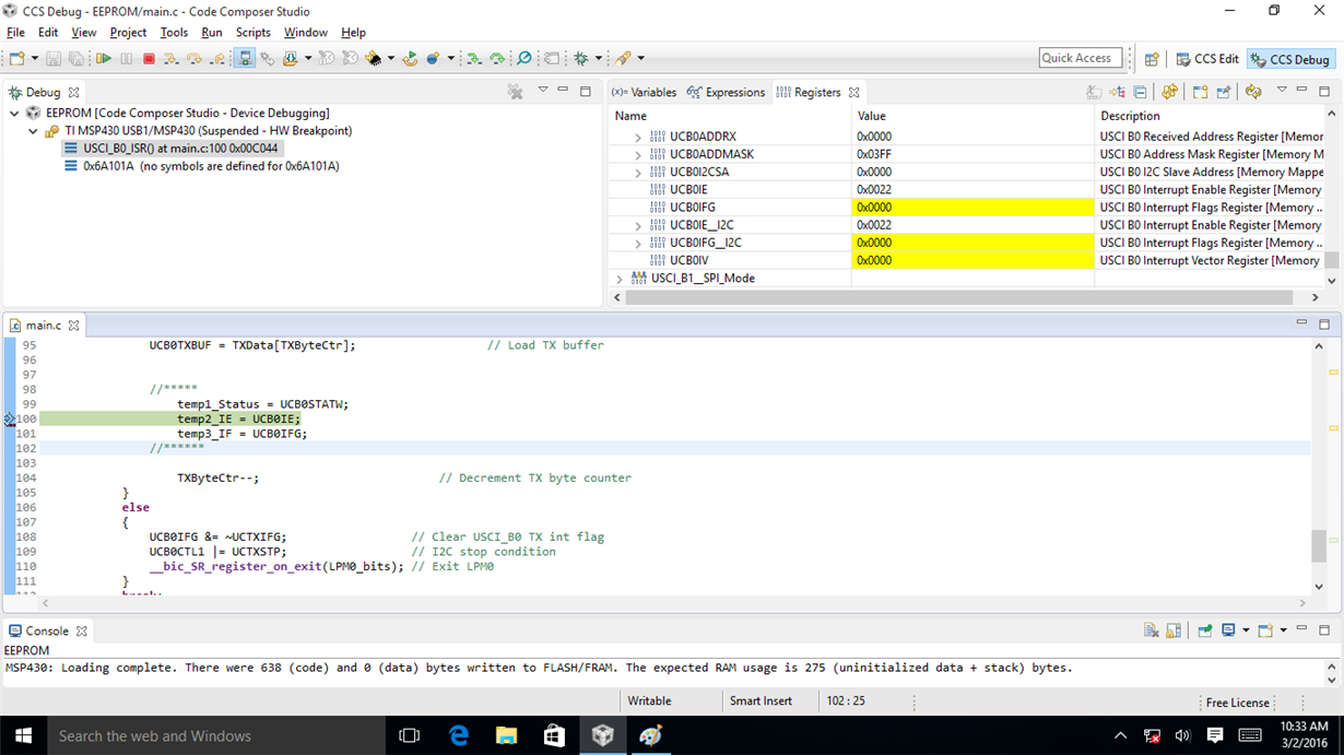

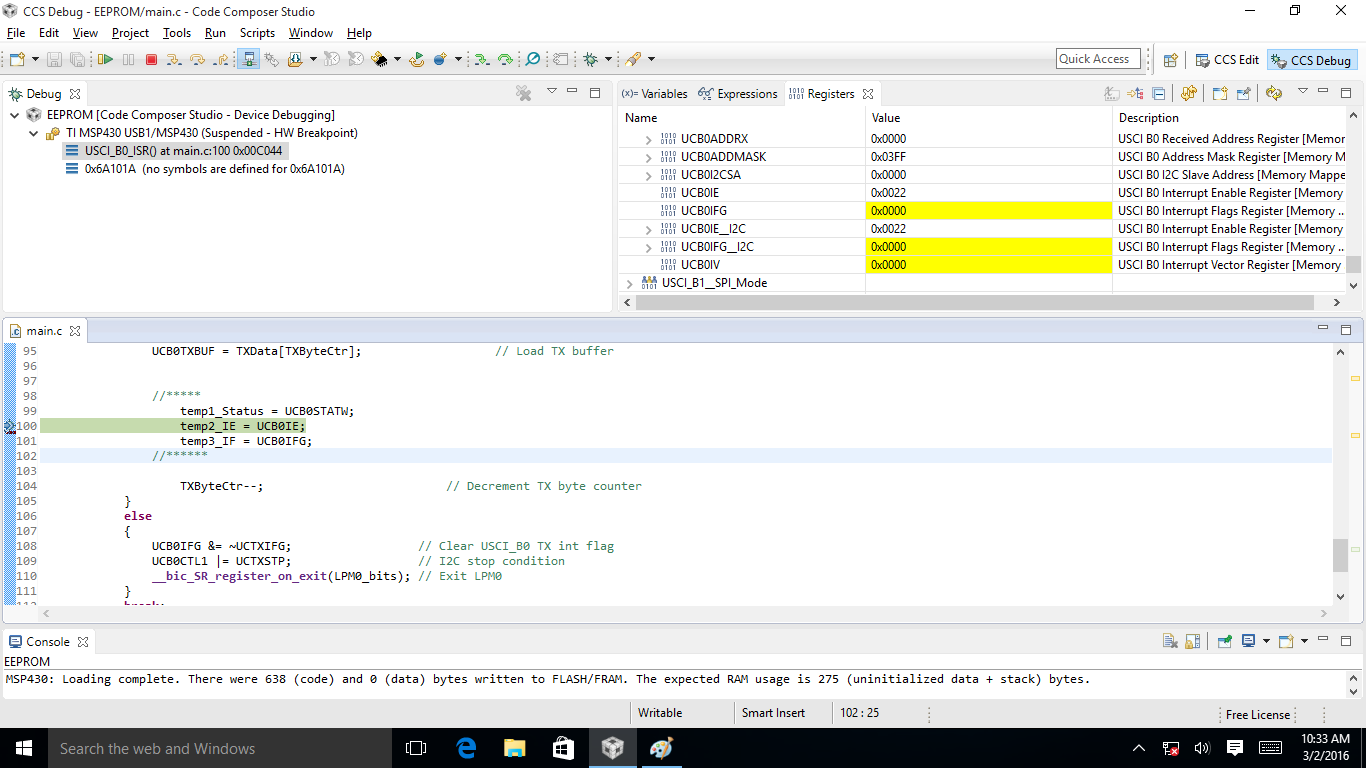

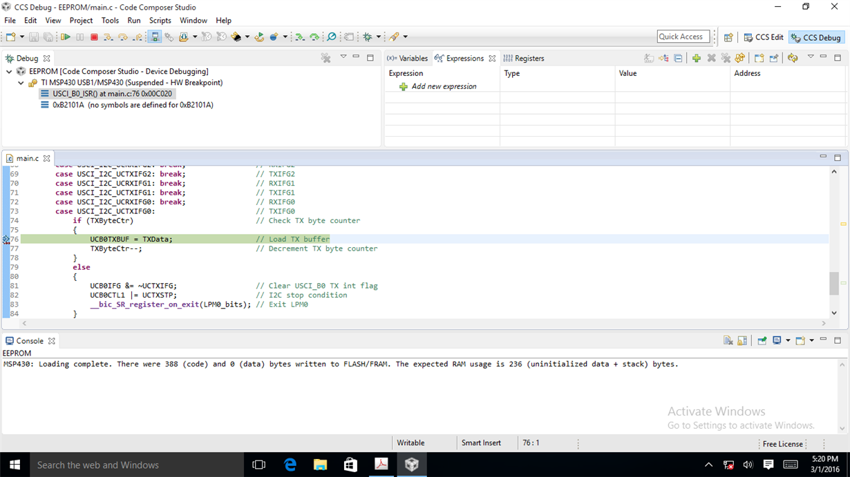

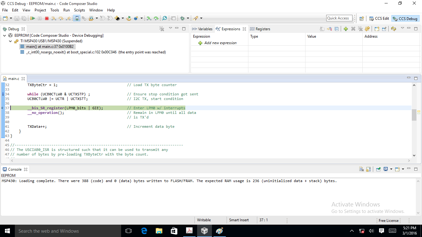

  •   Hi Dietmar,
    Thanks for your prompt reply.
    I checked this code with my 2 different prototype boards and have same behavior.
    Yes, It stay in LPM mode. but It goes once in I2C ISR then stuck at LPM.
    Please find attached screen shot of debug which shows both situations.
    Bhavdipsinhd

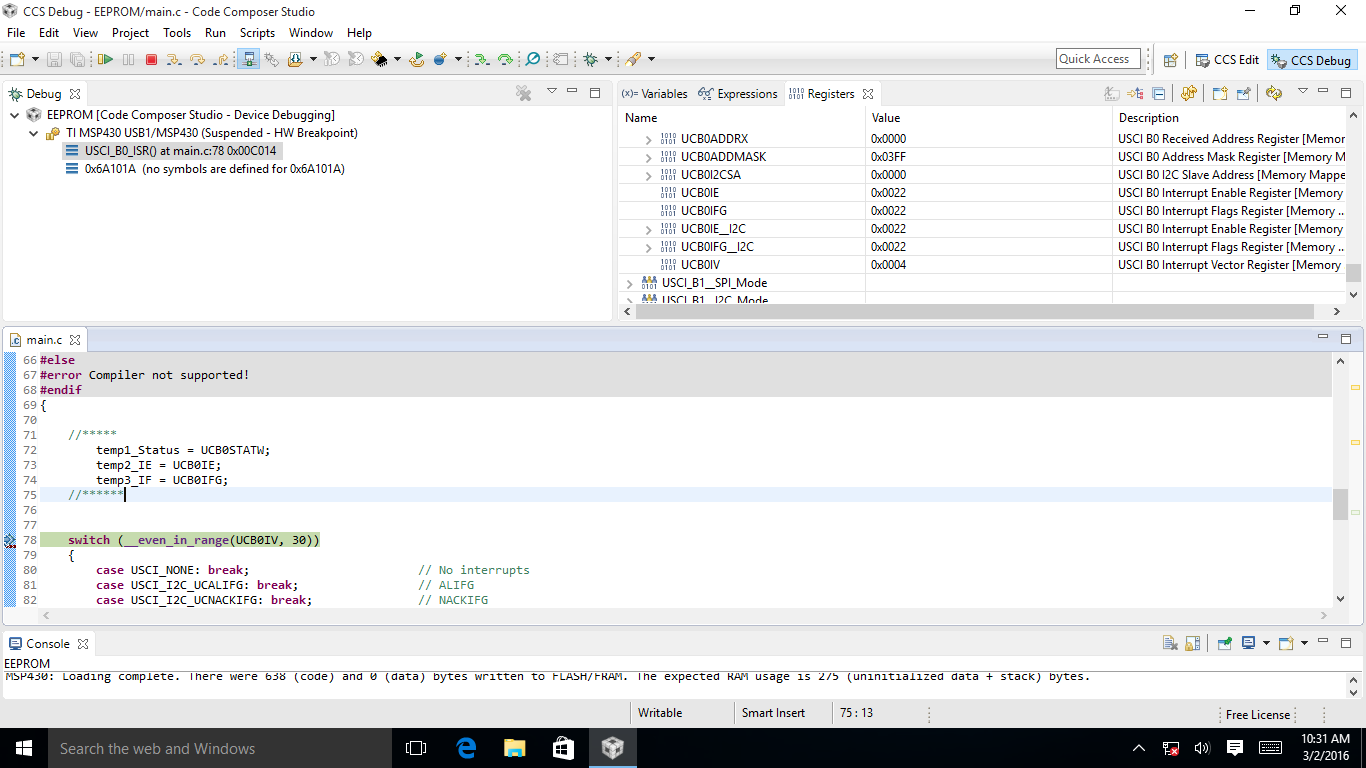

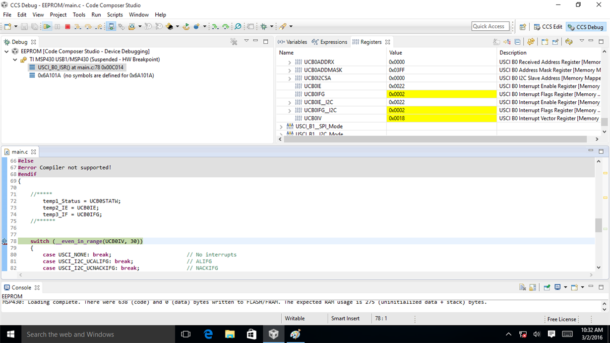

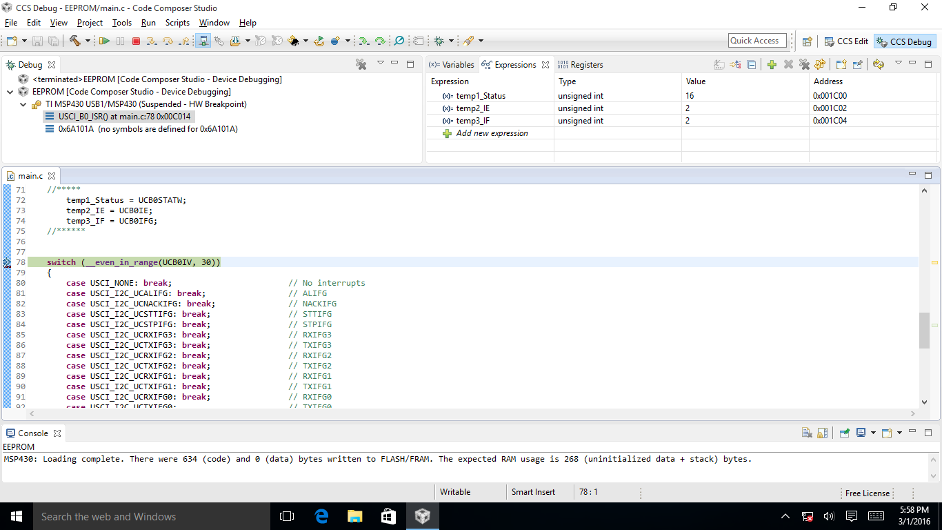

  • Thanks Dietmar for your reply and guidance.
    Please find below attached screen shots in which I take status, Interrupt Enable and Interrupt Flag resisters values at different instants sequential.
    I think which help you to give your best solutions.
    Thanks and Regards
    Bhavdipsinh
  • Bhavdipsinh,
    except writing the registers to a variable you also can use the register view to make the values easier to read.
    So in your 1st scenario a TXIFG is set and because this interrupt is enabled it gets executed.
    The 2nd scenario you see 32 in the UCB0IFG register which means the UCNACKIFG is set because this interrupt is not enabled the ISR is not executed. Maybe you should enable this interrupt in the UCB0IE register.
    The point is that you use the MSP430 in master mode right based on user's guide page #1007 an ACK is expected. So is this really send by the EEPROM?

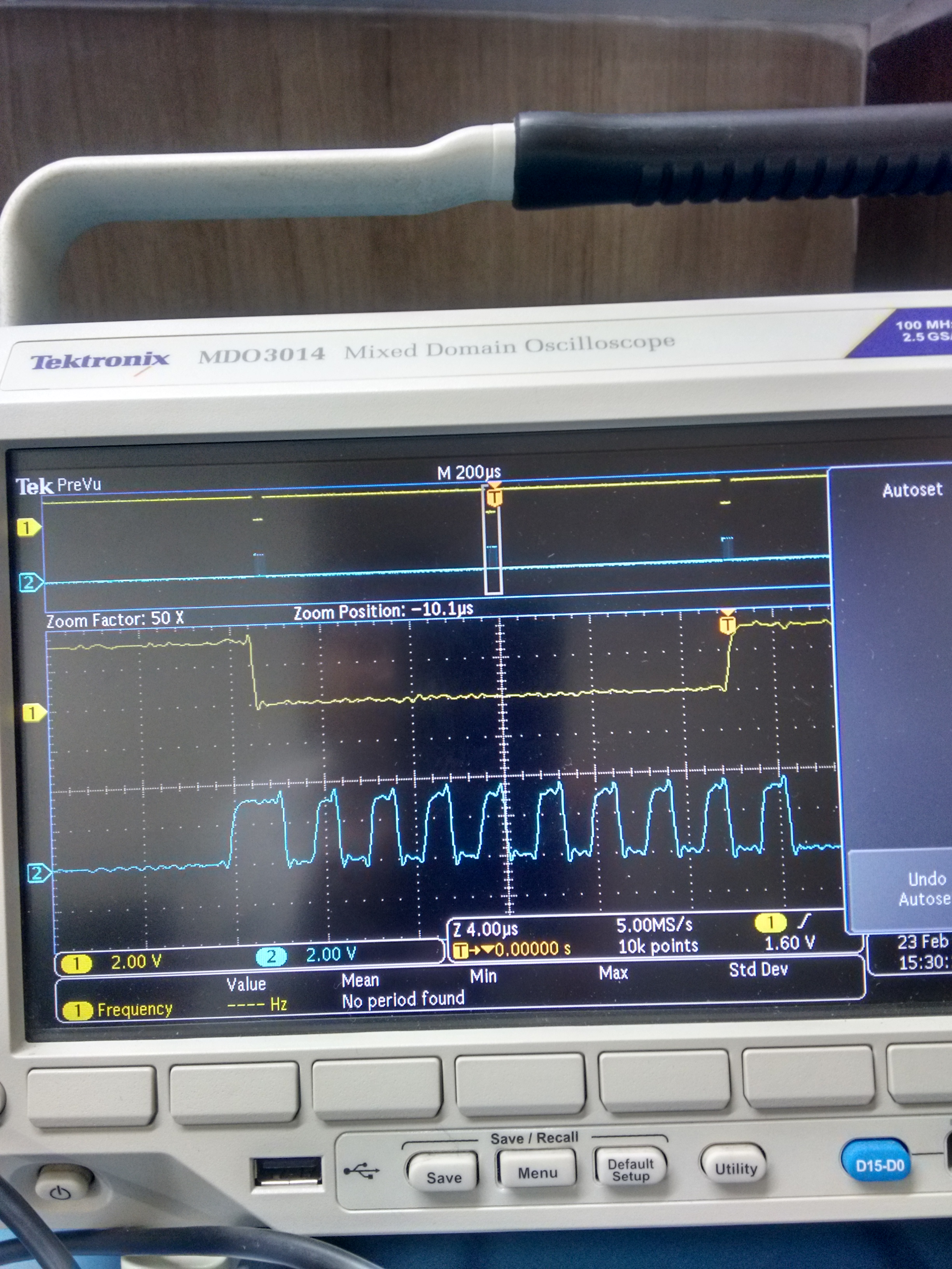

  •       Hi Dietmar,
    I have enable Ack interrupt and debug code but result is same.
    Please find herewith attached sequences screenshots and Waveform of CLK and Data pin output of I2C.
    I understand below points from it. Let me correct or give your inputs.
    1. In first Screen shot, Vector resistor value and Flag value indicate the interrupt for ACK after start I2C.
    2. In second Screen shot, Vector resistor value and Flag value indicate the interrupt for I2C Tx.
    3. In third Screen shot, Flag clears after serving interrupt.
    4. In forth, Again stuck at LPM and at same time you can see the resistors value.
    Please give your inputs.
    Bhavdipsinh
  • Bhavdipsinh,
    assume that you mean registers when to talk about resistors right? ;-)
    Yes your understanding is right:
    1. in the first screenshot UCTXIFG0 and UCNACKIFG are set because UCB0IV is 0x04 the Not acknowledgment part of the ISR is executed.
    In your code it does nothing except clearing the IFG automatically.
    2. Then in the 2nd screenshot only the UCTXIFG0 is that and UCB0IV is 0x18 which means that the Transmit buffer empty and the corresponding data were transmitted.
    3.in the 3rd screenshot you can see that you successfully clear the UCTXIFG0
    4. because no additional flags will be set it hangs in LPM
    The question is why sending an additional byte will not work or in other words why I2C will not shift again to empty the TX buffer.
    In the "code i2c.txt" you attached earlier the variable TXByteCtr was set to 1 means you transmit one byte.
    See also the comment above the ISR.

  • Hi Dietmar,
    Thanks for your continue support.
    We shortout the problem.
    I found that I need to set 0x50h as slave address instead of 0x00h or 0xA0h because 1 1010 000 0     first bit for start, next four bits 1010 for EEPROM default and next three 000 for A2,A1,A0 and last for read/Write. I need to consider it as 1101 0000    instead of 1   1010  0000  So after setting it in slave address resistor its working perfect.
     Please find find attached result FYR.
    Thanks for your response and guidance.
    Bhavdipsinh
  • Bhavdipsinh,
    great to hear that you were able to solve it and also good that it's related to slave address and not the eUSCI or EEPROM itself.
    So hope you increased your I2C experience by this exercise. Good luck for your project.
