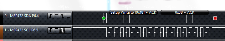

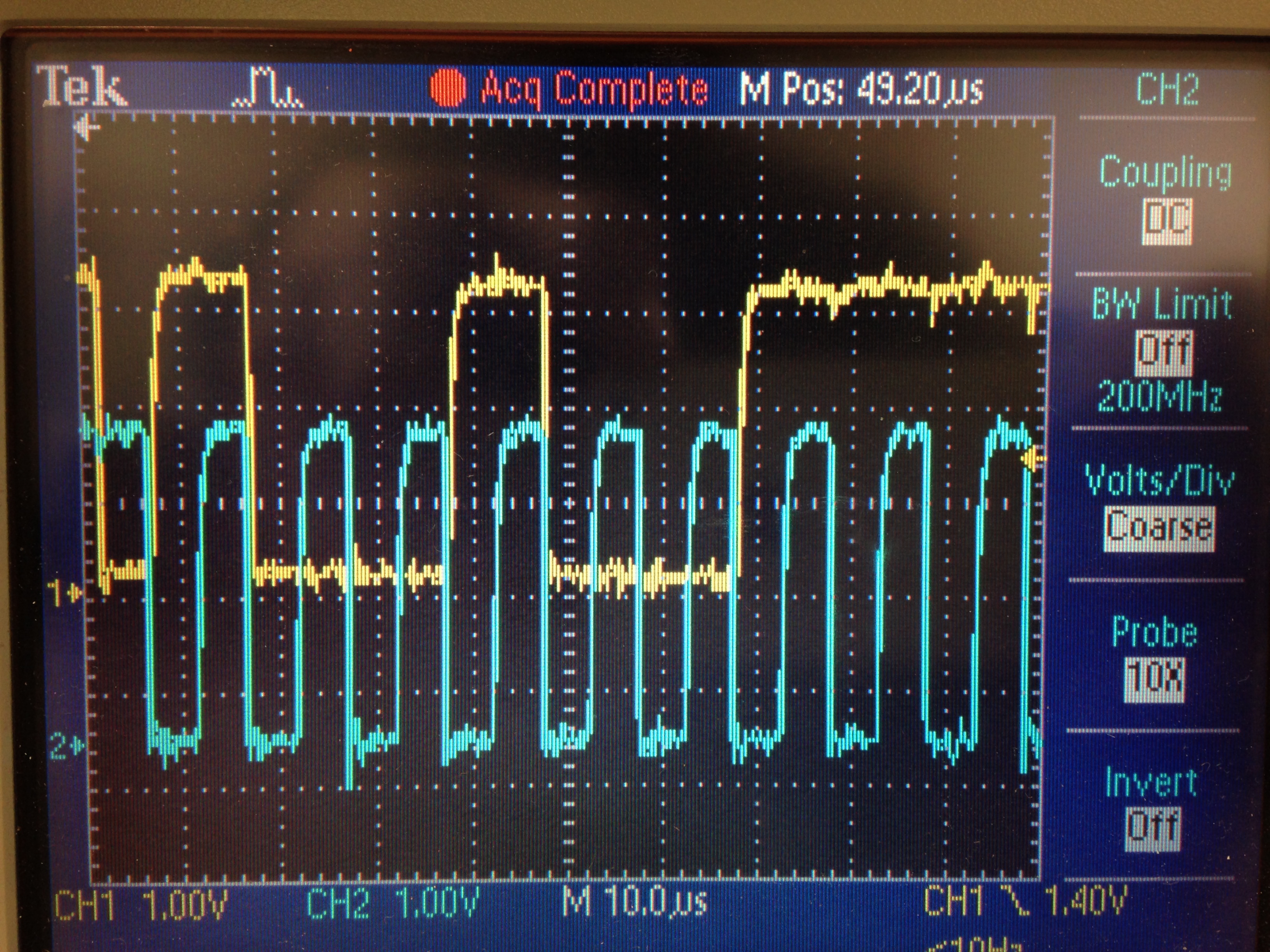

I am currently trying to set up a master-slave communication via i2c between an msp432p401r (master) and an msp430f5529 (slave). I am using modified example problems for each (attached). The code is far from complete as I haven't tested anything beyond the initial i2c start command. The slave interrupts the master via a GPIO pin to trigger the gpio_isr which calls the driverlib command:
MAP_I2C_masterReceiveStart(EUSCI_B0_MODULE);
At this point, I get a NACK response from the slave (see photo below). However, for this test, the slave register UCB1I2COA is set to 0x49, and UCB0I2CSA on the master is set to 0x49, so this should acknowledge? As a result, the euscib0_isr function never runs.
Maybe it's a simple problem that I'm just not seeing. Have I configured the interrupt incorrectly? Could anybody please help?
Jordan

Hi Jordan,
I ran a quick test and with this code, the slave acknowledge the MSP432.

Please give this a try and let me know if this works on your side.

Hi David,
Many thanks for your quick reply. I was just about to test out your code when I realised the problem - I had set
P4SEL |= 0x04,
which meant that pins 4.0 and 4.1 were assigned as I2C pins for USCI_B1 which is incorrect - it should have been pins 4.1 and 4.2, hence
P4SEL |= 0x06.
This gave me the not acknowledge flag. Once I changed this my ISR begins to run. A silly mistake, especially given that the error is one of the first few lines of code.
Thanks for your help.
