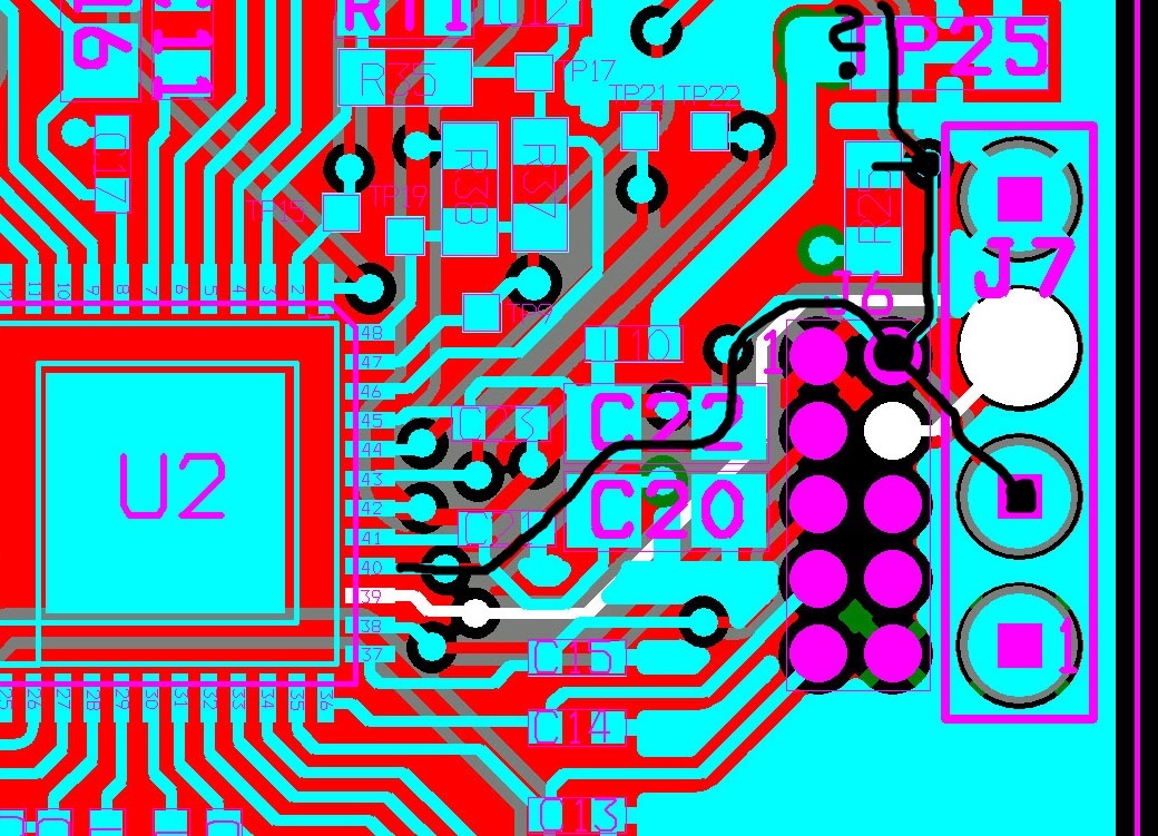

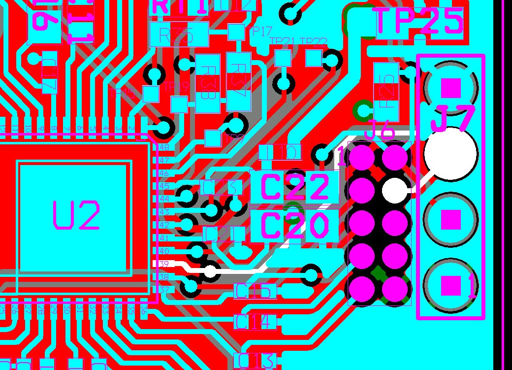

Hi Everybody,
I had a lot of problem until I found the cause, it take me a long time to trace it down.
It's the floating input TEST pin.
It is recommended to left the TEST pin unconnected. But the TEST pin is need in the factory to program the MSP430 with the Spy-Bi-Wire.
This TEST pin is very sensitive and picks up EMI very easy and the MSP430 behaves erratic, like resetting itself.
I came up with a solution the solves the EMI problem and still be able to run the Spy-Bi-Wire correctly. Infact the Spy-Bi-Wire works as well better with this configuration.
In the end of the trace I have add a 1k resistor to ground and a 1nF capacitor to ground.

  • It may be helpful if you tell us (a) which MSP chip you are using, (b) the silicon revision, (c) the PCB layout of the area near the signal TEST/SBWTCK, and (d) the EMI environment.
    Rene Baumann said:
    1. It is recommended to left the TEST pin unconnected. Why?
    This pin has an internal pull-down resister, thus normally does not need to have external pull-down.
    Rene Baumann said:
    2. Seems the TEST pin is a input, I can as well short it to ground and that solves the EMI problem too. Is there any problem with that?
    Correct. Except you will need to remove the short to ground when you use SBW, 4-wire JTAG, or BSL.
  • (a)  CC430F5137
    (b)  DIE Revision E
    (c)  4 layer PCB, a homogeneous ground and power plane, top and bottom layer are used for routing.
    (d)  I use a normal FL lamp and a EDS pistol, both of them can easy disrupt the MSP430. We have a lot of problems at the customer.

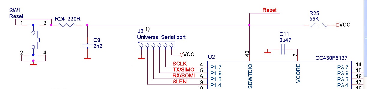

  • Hi Rene!
    Beside from your TEST pin, what are the connections made to your RST one (pin 40)?
    I can see it leads to R25 which is connected to an inner layer, so will be DVcc. And there is a trace going away upwards. Is there a filter capacitor somewhere far away from the device's pin?
    Dennis
  • Yes, there is a filter capacitor and a reset button. I must say the filter capacitor is not optimal placed. But after a lot of experiment it all come down to the TEST pin. See the reset schematics the schematic below.
    I have 3 other PCB design with the same MCU that have the same problem and they all have a different routings.
    Rene
