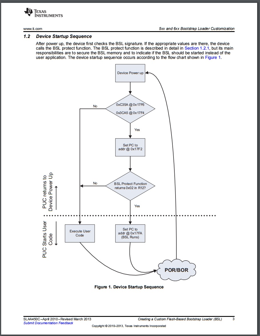

Hi everyone,
I am doing some stuffs about custom bootloader but I have a problems with it.
I put a LED signalization into BSL_Protect function which is on 0x17F2 memory. In this function I check if BSL sequence was entered.
BSL_Protect
              CLR      	RET_low                  ;lock (keep JTAGLOCK_KEY state)
              BIS     	#SYSBSLPE+SYSBSLSIZE0+SYSBSLSIZE1 , &SYSBSLC ; protects BSL
              BIS.B   #BIT3, &P7DIR
              BIC.B   #BIT3, &P7OUT
	      BIT     	#SYSBSLIND,&SYSCTL      ;check for BSL start request
              JZ      	BCC2BSL
	      CLR 		SYSCTL
              BIS.B   	#BSL_REQ_APP_CALL, RET_low
              BIS.B   #BIT3, &P7OUT
              MOV.W   #10000, R11
DELAY_LOOP:
DEC.W R11 JNZ DELAY_LOOP BIC.B #BIT3, &P7OUT BCC2BSL: RETA
As you can see the led MUST blink only if the exact bsl sequence was entered. When I burn the BSL code into MSP430F5529 led did not blink. All right. I enter the BSL entry sequence (hold RST, pulse on TEST, hold TEST, release RST, release TEST) and LED diode blinks. All right - I am into BSL code. BUT I press RST button again and the LED blinks AGAIN!
1. Why? I did not enter the BSL sequence! But If I press TEST button, release TEST button and then I press the RST button the blink is not done. Could someone explain it to me? The led blinks if I power off / power on the my board too.
2. Why R12 register? HOW the R12 register invoked the BSL code or an application code? Is something inside into MSP430 which cannot be seen? After reading a lot of documentation the start-up sentence is like this:
a) Hard reset
b) Check if 03CA5h and 0C35Ah is on the proper location: 0x17F4 and 0x17F6
c) After that the PC is set to 0x17F2 where is jump to BSL_Protect function
d) In the BSL_Protect function is a code which decides if BSL sequence was entered. If yes it sets R12 = 0x0002. If not the R12 = 0x0000
e) NOW WHAT? Now is called RETA instruction but WHERE? Could you please explain me HOW and WHERE the code jumps?

  • The MSP430 indeed has boot code that is executed before the BSL or your application code, and that cannot be seen.
    The BSL is run if the reset vector is empty, so I'd guess your BSL code accidentally erased it.
  • Sorry, but I do not understand. Why the BSL is only run IF the reset vector is empty ( 0xFF 0xFF ?). The reset vector cannot be empty because on that vector is jump to my application.
    A really DO NOT understand. So what can I do right now?
  • Not "only"; there are other reasons why the BSL is run.
    But if the BSL is run without the BSL signal, this would be the most obvious explanation.
  • I check my flash code and on the 0xFFFE address is not 0xFFFF so reset vector is not empty.. any idea? Please check my .asm code if its correct or please answer my other question if you could. Thanks!

  • Your application looks OK.
    However, it looks as if the interrupt vectors (including the reset vector) were overwritten when you flashed the BSL.
    Show the BSL's output . txt file.
  • OK, this is builded .txt file of my bootloader code:
    @1000
    04 3C FE 3F FF 3F FF 3F FF 3F 30 40 5A 15
    @1010
    00 08 08 04 D2 D3 42 02 3D 90 AD DE 04 20 3E 90
    EF BE 01 20 03 3C 0C 43 0D 43 10 01 E2 D3 42 02

  • @fffe
    5A 15
    There's your problem.
    What function is at this address?
  • Hmm, How can I found out it? I looked into .asm list file (.lst) and I cannot see anything. If you look into bootloader .txt code, 5A 15 are last bytes in @1000 section..
  • Ok. I look into .map file in my BSL code and:
    0000155a _c_int00
  • That is the entry point of the C startup code. Do you have a main() function?
  • Yes, of course main() function is included. In the main function is a bootloader code to communicate with PC... That code I downloaded from TI BSL package. This is my link file:

    As you can see I remapped FLASH section into 2KB bootloader section (whole BSL code).
  • You can name the function that runs the BSL "main", if you really want to. But in any case you have to replace the C startup code with your own version that does not set the reset vector.
  • thanks but how? This is original source code an I only changed BSL entry start sequence ...
  • Do you know that you cannot jump, call, or vector into any address 0x1010-0x17FE from any address outside of 0x1000-0x17FE ?
    The Reset Vector 0x155A simply would not work.
    You could utilize the Z-Area to do so indirectly.
  • Hi, As you can see, every JUMP or BRANCH outside is done in ZAREA, so it can be done? Or? Guys, I totally disapointed about this. I am working around it about 4 days and without any success. Example from TI BSL main page just does not work, so I eddited BSL from TI wiki - I only edited BSL entry sequence. But as you can see, there is a problem which I cannot discover. Please give me some guidance.... please, I am totally lost
  • As you can see, I said "... jump, call, or vector into ..."
    I can see that the address of the Reset Vector is. at 0xFFFE which is obviously outside the area 0x1000-0x17FE.
    I can also see that the value of the Reset Vector is point to 0x155A which is clearly inside the area 0x1010-0x17FE.
    Thus it is obvious to me that this is not going to work.
  • sorry, my mistake. You are talking about BSL output code right? But this is compiled output from TI example. So now I really do not know where is a problem? Why 155A is at RESET vector is for me clear. Its start of the bootloader main code. IF on the reset vector MUST be FF FF how can I edit .cmd or .asm file not to do this? Or I just manually rewrite RESET vector to FF FF and download into MCU?
  • When you generate the BSL code, you should not generate any RESET vector. If you use assembler, just do not tell it to generate RESET vector. If you use c-compiler, you have to twist its arms to not generate RESET vector. Either way, the starting point of BSL code should be given in the BSL-Protecting-Function, and should not be given in the RESET vector.
  • So when the RESET vector will not be generated it means that it will be 0xFF 0xFF, but Clemens Ladisch said:
    So when the RESET vector will not be set it still be invoked after RESET... or will not?
  • Actually, it is your assembler code that replaces the C startup code; your C_Branch jumps to _c_int00. It is the file that implements _c_int00 that also defines the reset vector to point to that address.
    The easiest way to handle this would be to remove the FFFE part from the .txt file. Alternatively, flash the BSL before the application, so the reset vector gets overwritten with the correct one.
  • Yes, I have a nice feeling that I understand. And do you know why R12 register is used to distinguish if the code jumps to BSL or to application code? It is something inside MSP430 that R12 is so important? Because only thing I do is that I set the R12 = 0x0002 if boot sequence was entered and then follows RETA... I think that R12 is wired inside the MSP430 and when is equal to 0x0002 the program jumps to 0x17FA location. Thank you
  • In the MSP430 ABI, R12 is the register used for the return value of a function.
  • OK, and where is R12 register compared in .asm file? I cannot see that operation...or the comparision is done "inside" MSP430? If you explain me full code flow it would be great! I mean the section where the device find out the path - if it jumps to application or into BSL memory. I understand that after R12 = 0x0002 program jump (somehow) to 0x17FA location where is ZAREA section and then simply branch to _init00 section which is the main function of BSL algorithm. If R12 is zero so program jump (somehow) to RESET vector and then to application code. But I want to know where the comparision is done. Thank you again! I am just curious..
  • All this is done in the bootcode, which is mostly undocumented, and even more protected than the BSL.
  • Yes I saw this picture many times... But it is not answer on my questions. But Clemens Ladisch's answer is enough for me. I changed reset vector to 0xFF 0xFF and it seems to be right. I will be testing it and let you know. Thank you you all.

    When I make the BSL seguence the LED diode blinks once time and I am into bootloader. Everything works. But when I press RST button again to reset MCU the LED diode blinks again! The LED stops blinking only if I totally turn off my device and then turn on OR if I press TEST button and then RST button the LED also doesnt blink.
    I do not understand, why? The reset vector points do 0xFF 0xFF or to application code. Aplication code works... Thanks
  • Apparently, the reset does not clear the SYSBSLIND bit.
