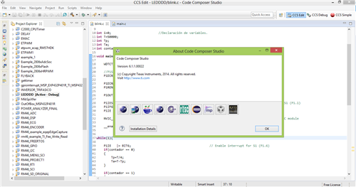

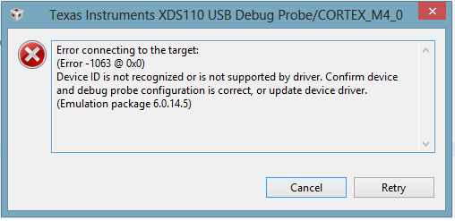

Hello good day, I have a huge problem when I try to record a program on the MSP432, the CCSV6 send me an error (see picture)

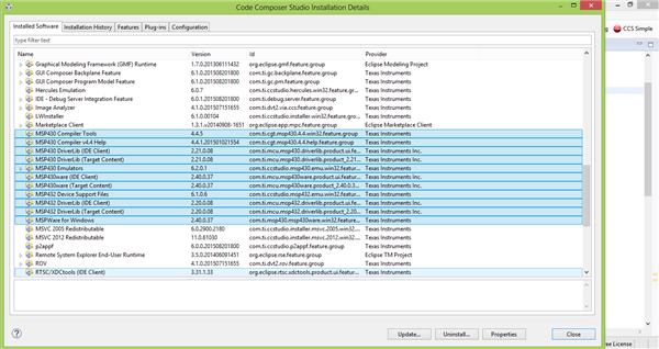

the version of software for the MSP, which have currently installed are:
and my version CCSV6 is:
would like to know, how I can upgrade or repair this error!

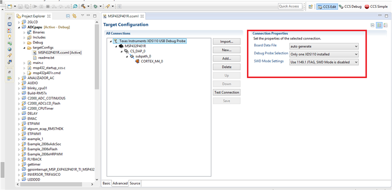

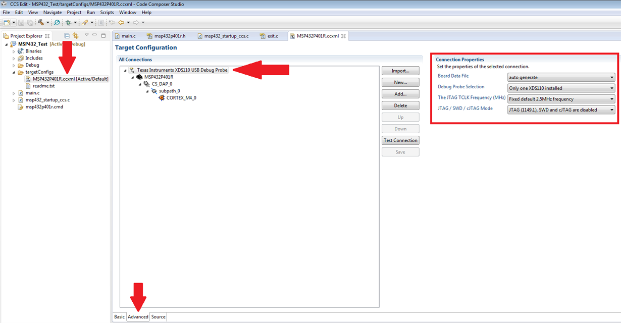

    Some things to check - could you please open your MSP432P401R.ccxml file, click on Advanced on the bottom of the window and look at the settings for the Texas Instruments XDS110 USB Debug Probe:
    Is it the same for you?
    If you click on Test Connection, what does it say? Note that if you changed something you have to click on Save first.
    If the connection works, great :) Then it should look like this:
    If not...I will brick my board later in this post (and then recover it), just go on, although you do not need to try the steps before the connection works.

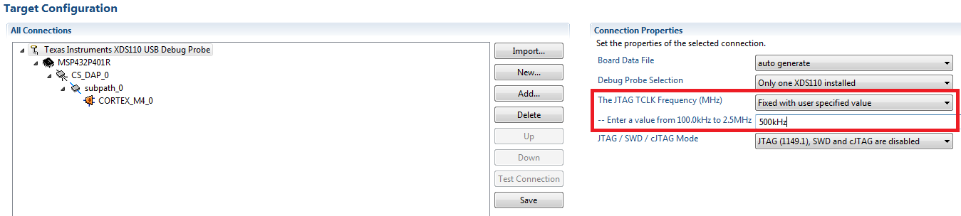

    Can you additionally check if the following settings are also right:

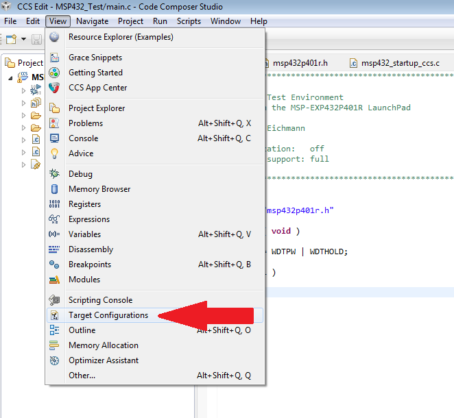

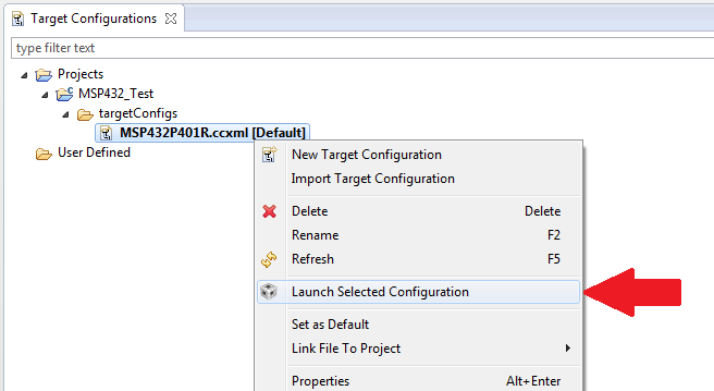

    Let's try to perform a factory reset to your board - to do so, click on View -> Target Configurations:
    A new window opens - expand the tree like shown in the picture and right-click on the MSP432P401R.ccxml file, then select Launch Selected Configuration:

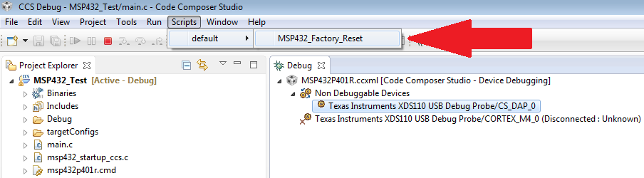

    Now click on Scripts -> default -> MSP432_Factory_Reset:
    Now press on STOP (red square), disconnect the power of the board, connect it again and give it a try.

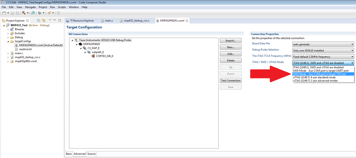

    To get it working again, select SWD Mode - Aux COM port is target TDO pin:
    Don't forget to save the new configuration. Now perform the Factory Reset as described above. After the power cylce you can switch back to JTAG.
    You can also experiment with the JTAG speed:

  • Thank you very much Dennis, I could solve my problem with the "factory reset"
