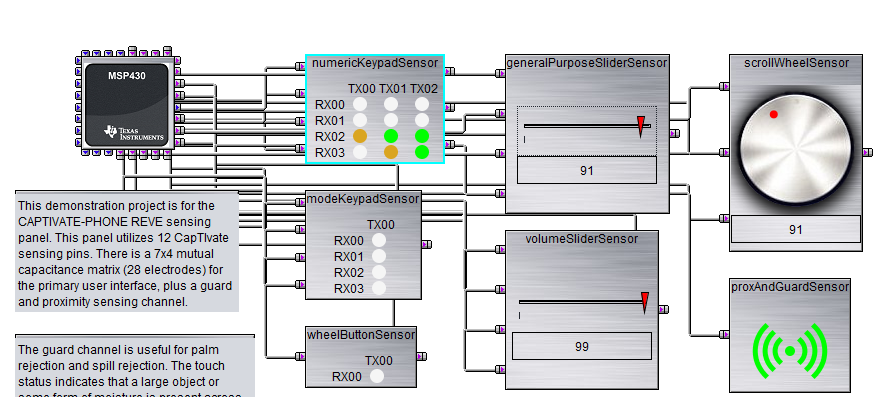

We are promoting MSP CapTIvate for our customer application which needs
moisture resistive solution.
We tried to spill some water on the CapTIvate EVM(CapTIvate Phone) to create
the moisture environment, but if the water stays between two or more touch key pads,
we get multiple touches for a single touch.
As shown below the water stays on some key pads and if we touch key pad "8"
the MSP recognizes more than 3 key pads(8,9,#) instead of only "8".
Is there any way to avoid multiple key touch for a single touch?
Is this avoidable with a guard channel? and please let me know the procedure
the settings necessary.
