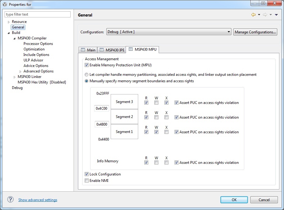

Hi, I saw the specs indicating FR6989 device comes with128Kb FRAM memory space, I recently involved in a project requires for 120KB Flash memory. I've try it out with Dev board and keeps getting error from compiler:
Description Resource Path Location Type
#10099-D program will not fit into available memory.  placement with alignment fails for section "READ_WRITE_MEMORY" size 0x1e0bc lnk_msp430fr6989.cmd /sample line 134 C/C++ Problem
I simply declare the memory space with code like:
#pragma PERSISTENT(MEM_DATA1) //first Data Block
unsigned int MEM_DATA1[30][512] = { 0 };
#pragma PERSISTENT(MEM_DATA2)//second Data Block
unsigned int MEM_DATA2[30][512] = { 0 };
for testing I only try to use 30*2*512 = 30KB memory space for each block, totally 60kb for 2 blocks, but it still pops out error messages.
The compiler will pass when I use MEM_DATA[20][512] = {0}, In order to make use of 120KB FRAM, do I need to change the memory map to fit memory block?  What else should I do?
