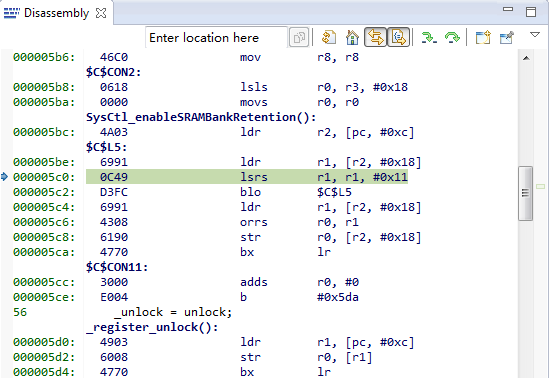

           I've already tried your method to add SysCtl_enableSRAMBankRetention(SYSCTL_SRAM_BANKEN_BNK7_EN);, but there is also a problem. The code cannot go into LPM3, while it stops in the function SysCtl_enableSRAMBankRetention(SYSCTL_SRAM_BANKEN_BNK7_EN);. The disassembly code is as follows:
    In contrast to the C code of the function, I guess it stops at "while (!(SYSCTL->SRAM_BANKRET & SYSCTL_SRAM_BANKRET_SRAM_RDY));". The SRAM_RDY bit is always 0, and the code is trapped here.
            As the Code cannnot go into LPM3, the current consumption is not right. What should I  do next?
