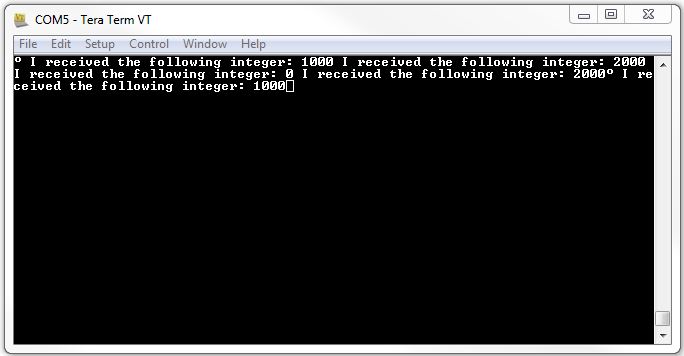

    First, welcome to E2E and thanks for providing your code.
    For simulating the "aci" integer being sent from your C# application, I just used a Tera Term terminal (COM5, 9600 baud rate). After calling the "serialEvent()" function from inside the "loop()" function, I was able to read the integer (1000, 2000, etc.) that was entered in the terminal.
    This should fix your communication problem. Below, I've attached my code and a screenshot of the terminal for your reference.

    Firstly, thank you for help.
    Program worked smoothly. But there is one small problem. For example;
    - Servo motors is giving late response ( ~0.5 s),  jump occurs. No similar problems in Arduino. Maybe because of baud rate? (MSP432=9600, Arduino=115200)
