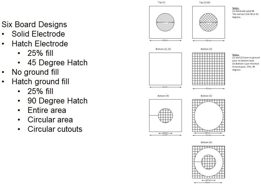

Is there any effect when we design circuits on FPC(Flexible printed circuit) ?
Or, is there any points to be noted when we design circuit for CapTIvate on FPC?

Hi Chris,
Thank you for your reply.
Please let me confirm, does 'hatching' means removing unnecessary copper on the circuit ? And, does 'no ground plane at all directly below the electrode' means 'no placing ground plane on adjacent layer of pattern layer' ? Sorry for basically question. Please teach me.
