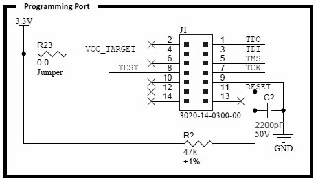

My schematic of the JTAG looks like this...
I have confirmed the pin-out and still unable to program the device.  What am I doing wrong?  Would connecting RST directly to 3.3V destroy the FET?  Can we try a two wire JTAG on this chip?

    I have a 4-wire schematic exactly like the recommended schematic.
    Except for the test wire is just an open connection.  According to note C it is only for multiple programming ports.  I will put an O-scope on TDO/TDI/TCLK/TMS/TCK and attempt to post it.

  • Here is the schematic of the programming port

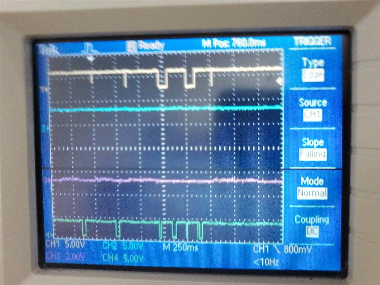

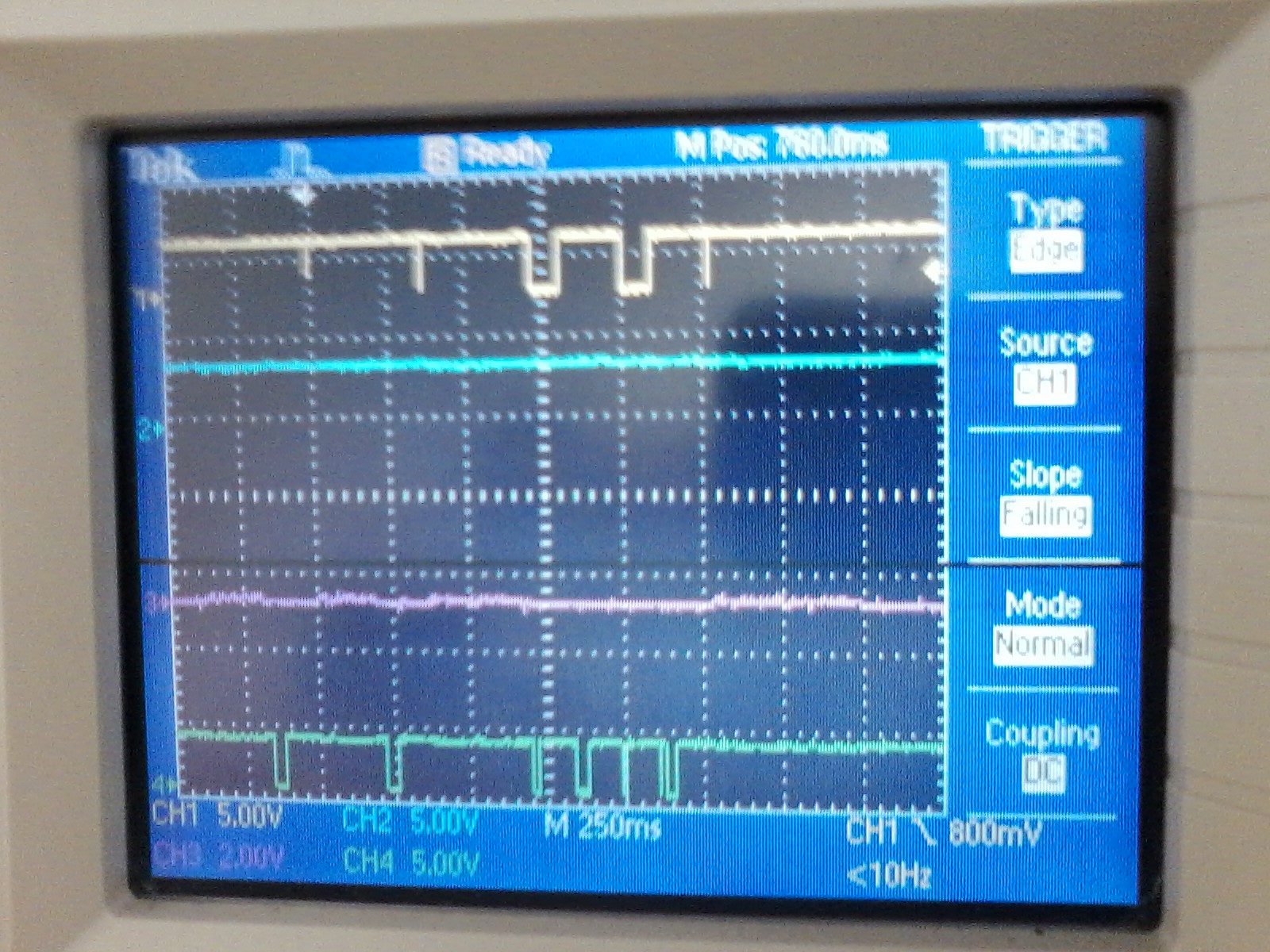

    Comm picture are as such.
    CH1 - Yellow - TDO
    CH2 - Blue - TDI
    CH3 - Purple - TMS
    CH4 - Green - TCK
    Now TMS looked very noisy so I zoomed in on the noise.
    And it was consistent.
    And the programming sequence.
  • So continuing to bang my head against this problem I've tested the circuit again this morning.  The noise in TMS went away, but so did all signals.

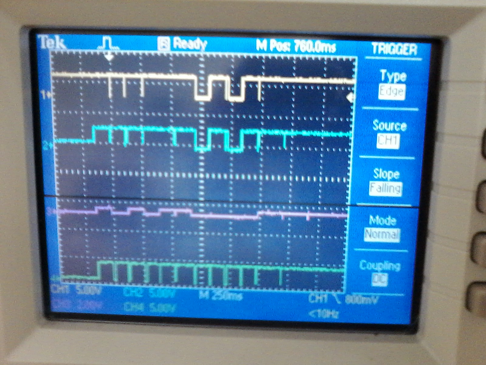

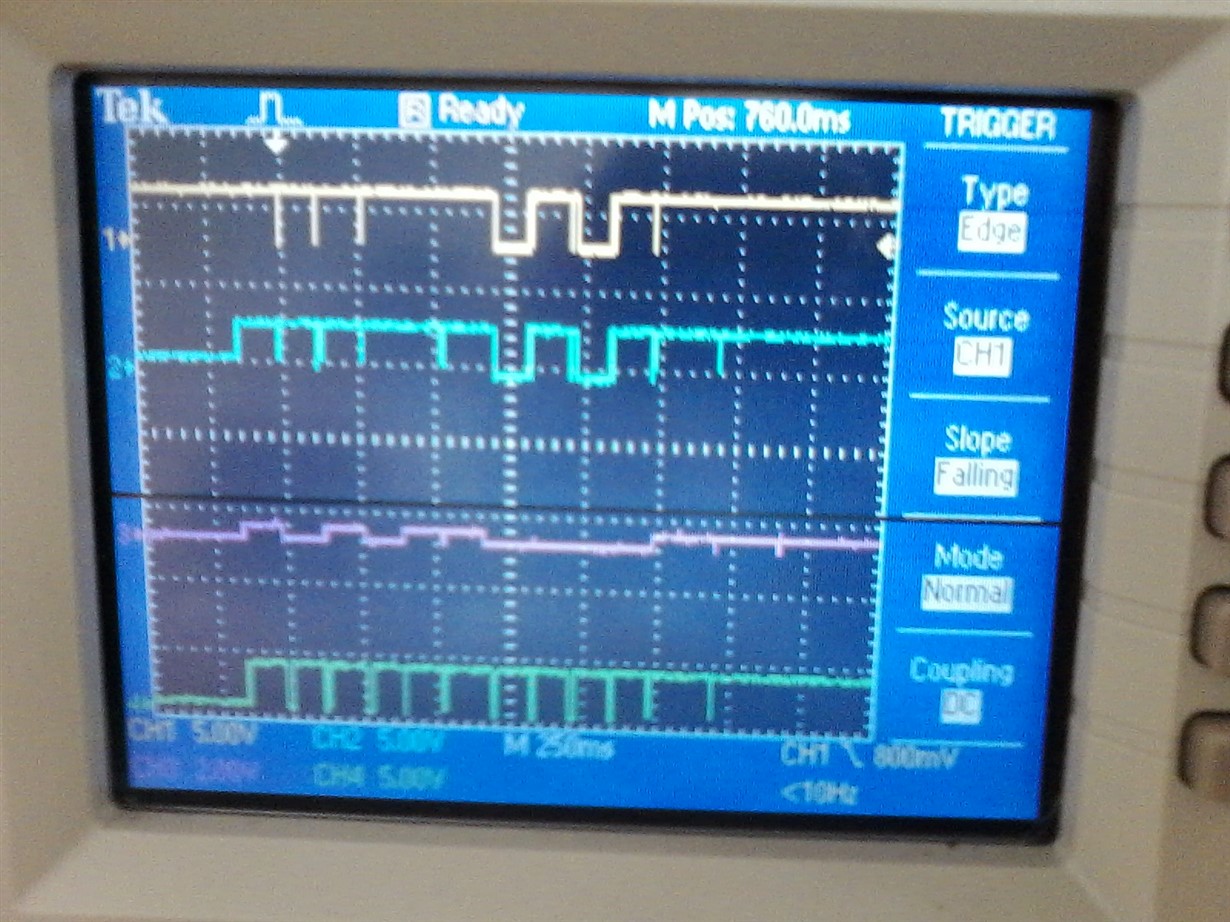

    So I plug in the other programmer MSP-FET430UIF and got a different results.  Seems the TMS doesn't get driven high enough...
  • Hi Michael,
    What Vcc is your external power supply operating at? What happens when you try to power the MSP430 device through the FET (using JTAG pin 2 instead of 4)?
    Ryan

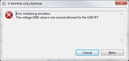

  • Using MSP-FET first leaving R23 installed and removing 3.3V rail regulator the voltage to the MSP430 was 1.08 V giving the following error upon any attempt to program it.
    Using the UIF same error occured.  Unknown device.  The rail voltage was 3.1V.  The O-Scope lite up as such...

    The MSP-FET supports 4-wire programming. The error you mentioned before, where "The voltage 1086 value is not correct/allowed for the USB FET" is sometimes produced if the MSP-FET is oriented incorrectly. Have you confirmed that pin one of your JTAG header matches pin one of the MSP-FET device? You might try rotating the connection by 180 degrees to see if it produces any changes. Otherwise, you believe that the MSP-FET device you purchased was delivered already defective and has never worked?
