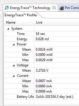

I'm starting to test the MSP-EXP430FR4133 and running the msp430fr413x_RTC_01.c sample code, the power consumption in sleep is way to high from the one advertised for the FR4133.
This is the graph:
This is the code:

Where can I find more samples about low power configuration and tips? What can I do to improve this code above?
