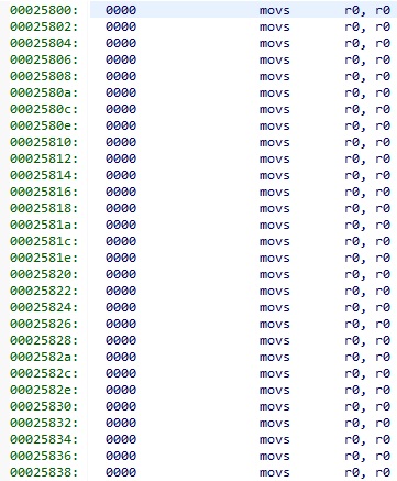

I have tried to program a MSP432 with MSP-GANG. The previous steps can success, while the "Verify" step fails, showing "ERROR 58: Verification Error". According to MSP-GANG manual, I compare code file and flash data. There are two regions which have differences, 0x00005CE0~0x00007FF0 and 0x00025800~0x00027FF0. I debug the code with XDS100 V3, and check the disassembly window.
I don't think my code will modify the contents in these two regions. Additionally, I checked the binary code in debug mode in these two regions, and they are the same with the code file. How can I figure out why?Thank you!
