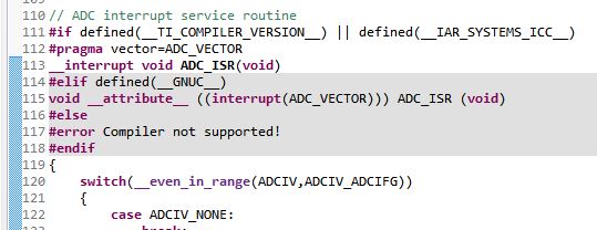

    By extra stuff, I mean the following, which is not there in the UART ISR that I wrote. However both ISRs work fine.
    #if defined(__TI_COMPILER_VERSION__) || defined(__IAR_SYSTEMS_ICC__)
    #pragma vector=ADC_VECTOR
    __interrupt void ADC_ISR(void)
    #elif defined(__GNUC__)
    void __attribute__ ((interrupt(ADC_VECTOR))) ADC_ISR (void)
    #else
    #error Compiler not supported!
    #endif
    Let me know.
    Rohan L
  • Hi Rohan,
    That has to do with the compiler being used for the example code. As this is example code being provided, it can work with the TI compiler, the IAR compiler, and the GNU compiler. Depending on which compiler is being used, there is a different way of initializing the interrupt vector. If you are using the TI compiler or the IAR compiler then you want to initialize this like so:
    It looks like you have it set up similarly in your UART ISR so that is good. You don't have to add the extra code unless you plan on having your code run with other compilers.
    As you can see in the above snippet, lines 114-118 are grayed out as they are not relevant because I am using the TI compiler for this code.
    Akash Patel
