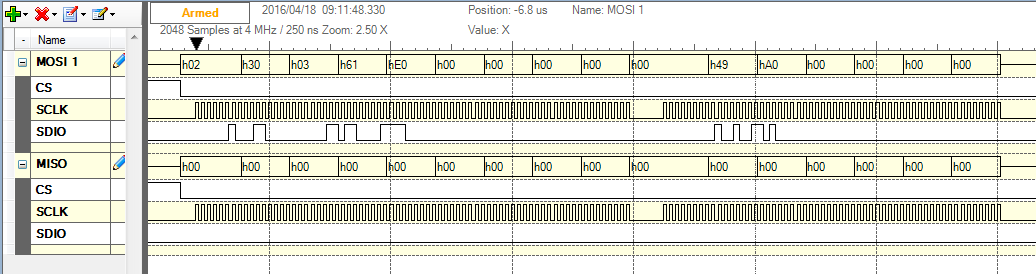

A screenshot of the transaction.  SCLK and data are correct, though CS doesn't return to high after the transaction.
  • Nishant,
    It is not readily apparent as to what the issue is. I will continue to investigate to determine possible leads. Could you also provide a screen shot of a passing case (the 90% of time) where the CS returns high for comparison?
    Chris

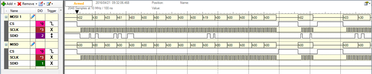

  • Hi Chris,
    Thanks for offering to help.  This is the normal transaction.  Ignore the values of the last 8 bytes in the transaction as those are uninitialized data bytes.
