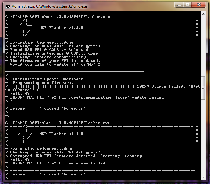

I am having trouble updating the firmware of my MSP-FET Flash Emulation Tool device.
I know it is not a hardware issue with my MSP-FET, because I am able to update and recover the firmware on another computer using the same method.
When I try to run the MSP430Flasher.exe using the command prompt, I get the following errors shown in the image.
During the update, only my MSP-FET Green Light (Power) stays solid.
Any help would be greatly appreciated.

Hi Kevin,
Thanks for providing this information. On the Windows 7 PC, it could be missing some Windows USB drivers, as described in the two threads below. Could you please check if your case is similar and let me know?

Hey James,
I tried the above recommendations and searched in the folder directory, but I was not missing any of the mentioned files.
