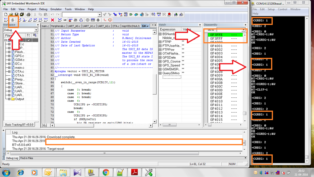

We are working on a project with MSP430F5419A for GPS tracking application. Our project development is over and installation of units in the field is half way. We are facing one issue in some units, that the controller stops sometimes. It will get recover only when we REST the board, and continues to run for some duration and stops again.
OBSERVATIONS:
  1. Issue persists only in some units.
  2. Sometimes the Interrupt routines continues to run (Tested with LED ON/OFF in timer interrupt) and only main code fails. Sometimes both fails.
  3. If we run the failed unit in debug mode, and we BREAK the code when it fails (During GSM response +CGREG: 1) we see that the current execution line shows somewhere in the memory not the code. Below image FYR.
Details FYI:
IAR: V5.10.1
Clock: Internal 16MHZ.
Kindly help us to resolve the issue.

    Hi Brian,
    Thanks for your reply. I have generated the map of my code with Static Stack Tool in IAR. Please find the attachment.
    I'm not able to verify the "max stack usage + max call chain for worst-case". Kindly advise me how to verify that using the IAR tool.
    Manoj.
