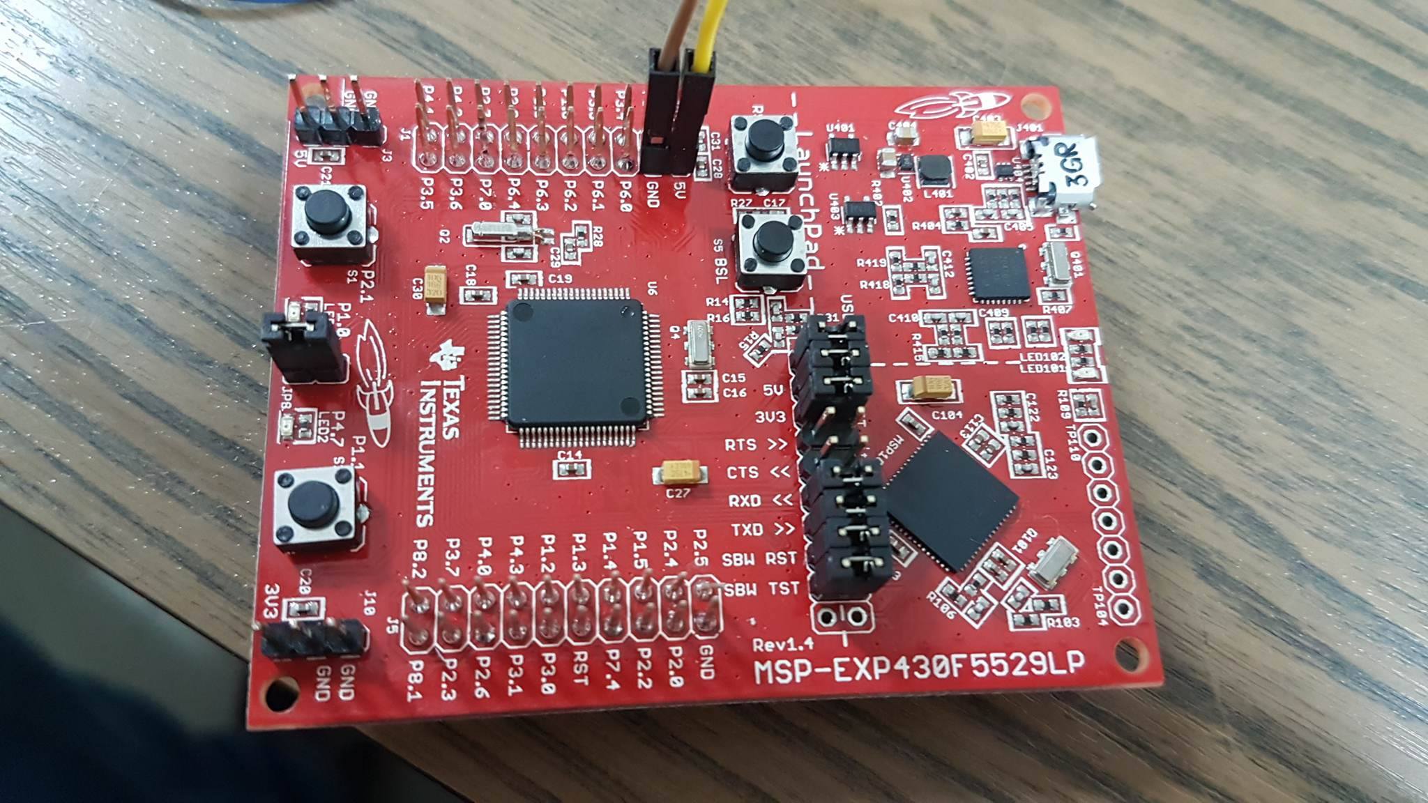

  • Tony thanks for your answers. I connected as you said (i attached a photo) but nothing changed..Why? My jumpers are connected as you see on the photo.
  • There appear to be four cables connected. What are those?
  • 5V pins and ground pins..i labeled on the picture.
  • But why are there two 5V cables and two ground cables?

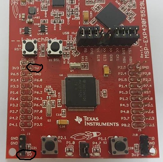

  • Because one pin source did not work and i tried that way..But it did not work too..One pin source pictures are below..

  • As you see on the picture i only sourced the 5V pins. Yes i sourced it with 5V dc supply but it doesnt work...No i only sourced it with 5V not 9V.
  • What does a multimeter say on the other 5V pin when you have your 5v source connected?
    Do you get a (around) 5V? if so what does a 3.3V pin reads?
  • It says 5V on the all 5V pins when i supply 5V pin on the left bottom corner but 3V3 pins give 0.6 volt.. So my emulator is break down??
  • Power it up with "normal" USB again and test,

  • Your problem could be fact that you use v1.4 board which includes TPS2041B power switches. Perhaps Brian missed that and whole time analyzed wrong (rev >= 1.5) schematics.
    >By the way, if you show me this question is answered anywhere on this forum, i will apologize and leave here.
    It could be so that you can start apologise now. Indirect answer is in FAQ of Launchpad User's Guide:
    Q: I'm trying to power the LaunchPad from a USB power supply (not an actual USB host), and it is not working. Does the LaunchPad not support this?
    This problem is fixed in Rev1.5 and later LaunchPads. Unfortunately Rev1.4 does not. USB hubs typically shouldn't enable power to their downstream devices until the hubs themselves enumerate on the host, and that's what the TUSB2046 on the Rev1.4 F5529 LaunchPad does through the TPS2041B power switches. If the hub never enumerates, power is not provided to the target F5529. Because the downstream device is permanently attached in this application, the TPS2041B switches are not required by the USB specification. Rev1.5 and newer F5529 LaunchPads have these switches removed, to avoid this problem. Again, the benefit of the hub is single-cable development. Other power supplies can still be applied via the power header

    No. You shall look at rev 1.4 schematics and rev 1.5 schematics, compare power part. Think of simple hack - how to short mentioned power switch on rev 1.4 so it behaves as rev 1.5. In case you need help in this regard - feel free to kindly ask questions. Ranting and requesting ready to use solutions on golden plate usually does not increase your chances. Further reading

    Please allow me to clarify a little bit of what happened with the power sequencing on the F5529LP, then I can make some suggestions for how to connect your different power rails.
    In the original release of the F5529LP, we (TI) made the decision to only enable the 3.3V converter when the UCB is enumerated (connected to a USB host).  The original thought here was that in all use cases, the LP would be connected to the pc via USB (for debugging), or would be powered externally through the 3.3V and 5V power headers at the bottom of the board.  After release, we realized there was significant demand for powering the LP through a USB power supply (that does NOT include a USB host), so we redesigned the board to accomodate this.  As Ilmars pointed out, unfortunately, you have an old version of the LP that does not support enabling the 3.3V converter when the USB is NOT enumerated.
    Now, this does not leave you completely high and dry.  If you want to power your LP from a non-USB Host source, you can do so through the 3.3V and 5V connectors at the bottom.  However, you need to disconnect the 3.3V and 5V jumpers between the emulator and the target side of the LP.  This will bypass all the power configurations in the emulator and let you power the LP device directly form an external source.
    For your application, you can power the 3.3V (VCC) rail with 3V from batteries to power up the LP device.  I don't think you need the 5V rail (unless I missed something somewhere), so you can ignore this.  Your 9V rail for your motors can share the ground with your batteries if you would like, although I would recommend isolating these rails if possible to prevent injecting noise from the motor on your LP power rails.  As mentioned above, just disconnect the 3.3V and 5V jumpers on the emulator/target header, and this configuration should work fine.  You can still debug the application using the emulator as long as the ground jumper is still connected.  If you don't want to debug the application, I recommend removing all the jumpers on that header to prevent undesired voltages on those pins.  Particularly important are the RST and TEST lines (for SBW JTAG communication), as these can potentially hold the device in reset.
    I apologize for the confusion between the LaunchPad revisions, but it is an unfortunate side effect of the product evolution process.  Hopefully the above, combined with the support of some of the other forum members can help you get your demo up and running.

    My point about removing the 3.3V and 5V jumpers between the emulator (eZFET) and the target sides of the LaunchPad was to separate out all the power management on the eZFET side from the external power connections that will be made to the board. Without removing these jumpers, you will be back-feeding the 3.3V converter if you apply a voltage to VCC. This also will power the eZFET, which could lead to issues where the emulator holds the device in reset or something because it is not receiving instructions from the PC over USB telling the eZFET what to do. While the 5V does not have a voltage converter, it is connected directly to the USB plug, which means if you plug USB in with an external 5V rail on the device side, you could potentially cause issues there.
    Removing the 3.3V and 5V jumpers makes those rails on the device side sourceless on the board. Now you are safe to connect external power. The benefit of doing this is that you can STILL use the eZFET through the USB to the PC to interface the F5529 (either through JTAG or the back channel UART), while keeping the external power source.

    The 3.3V rail is generated in the eZFET side from the 5V rail. So if the 5V jumper is in place and 5V is applied (either through USB or externally), it will generate a 3.3V rail for VCC (if a USB host is present). If you already have an external source on the 3.3V/VCC rail, this would not be good. In the original post, mehmetserdarcelik mentioned he wanted to connect 3.0V from batteries to VCC. This is why I brought up this point.
    I brought up the 5V _with_ the USB plugged in to explain the revision change from 1.4 to 1.5, and why those changes were necessary. On rev1.4 boards, applying 5V externally (with the 5V jumper between the eZFET and target sides in place) is effectively the same as connecting the USB to a wall charger that is NOT a USB host. Since the rev1.4 board requires a USB host to enumerate the eZFET before it will enable the 3.3V converter, it does not matter where the 5V comes from, it will not enable the 3.3V converter if there is no USB Host present.

  • > Since the rev1.4 board requires a USB host to enumerate the eZFET before it will enable the 3.3V converter, it does not matter where the 5V comes from, it will not enable the 3.3V converter if there is no USB Host present.
    Ok. Now it is definite answer. On the other hand what is suggested solution for rev1.4 owners willing to do some soldering to fix the problem? Same as I did - remove power switches U401 and U403, solder "always on" jumper wires?

    The hardware solution would be to bypass the enable single from the eZFET controller and have the 3.3V converter always on. I don't have the schematics in front of me to give specific changes, but this is effectively what you are trying to do.

  • what is suggested solution for rev1.4 owners willing to do some soldering to fix the problem?
    1. Remove U401 and U403, and connect the pads for pins 5 and 1.
    2. Alternatively, disconnect the enable signals (pin 3) from the hub's PWRON signal, and connect them to GND instead.
