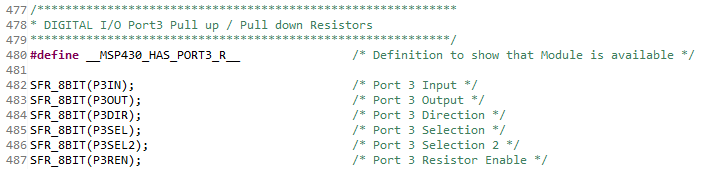

  • can you tell me how to define the port 3 fuctions in header file ?

  • OK, in this case there is nothing to do for you! The header file for the MSP430G2553 already includes everything needed for port 3:
    Just use it as you would do for port 2.
