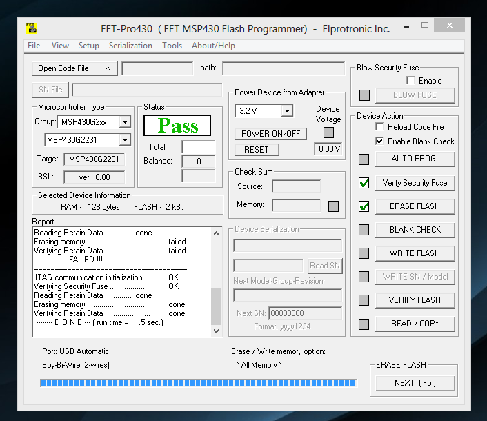

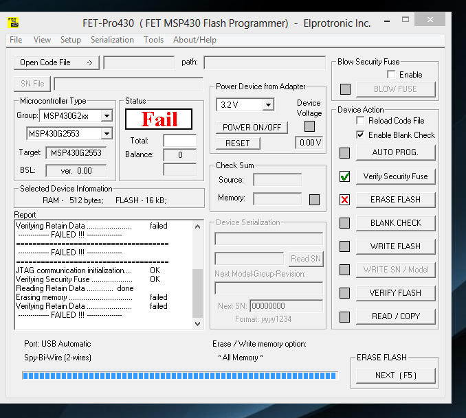

Hi, i'm trying to program a MSP430G2553 (that I bought) using Launchpad (MSP-EXP430G2 Rev1.4).
The connections are rigth but I'm getting this error below (at programming):
MSP430: Trouble Writing Memory Block at 0xffde on Page 0 of Length 0x4: Could not write device memory
MSP430: File Loader: Verification failed: Target failed to write 0xFFDE.
Anyone knows what is that?

Please uncheck "Enable" in "Blow Fuse" section and try erasing the flash. DO NOT try to blow the fuse.
