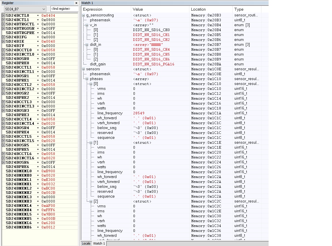

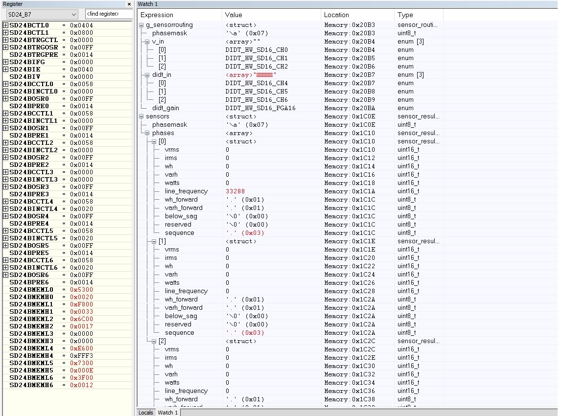

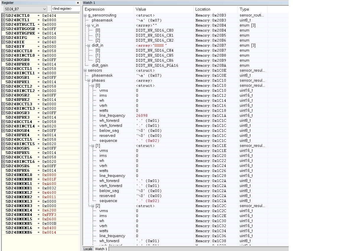

    I've been trying to understand why I don't get any readings, except for frequency.
    I've attached some prints of my debug (3 executions). There you can see that the data registers for SD24 (SD24BMEM) change but in the return sensor_results_t *sensors the only that changes is the frequency and the sequence counter.
    1st Execution:
    2nd Execution:
    3rd Execution:
    What am I missing? Can it be a problem in the way sensors are routed or a problem in the way your library retrieves data from the SD24 registers?
