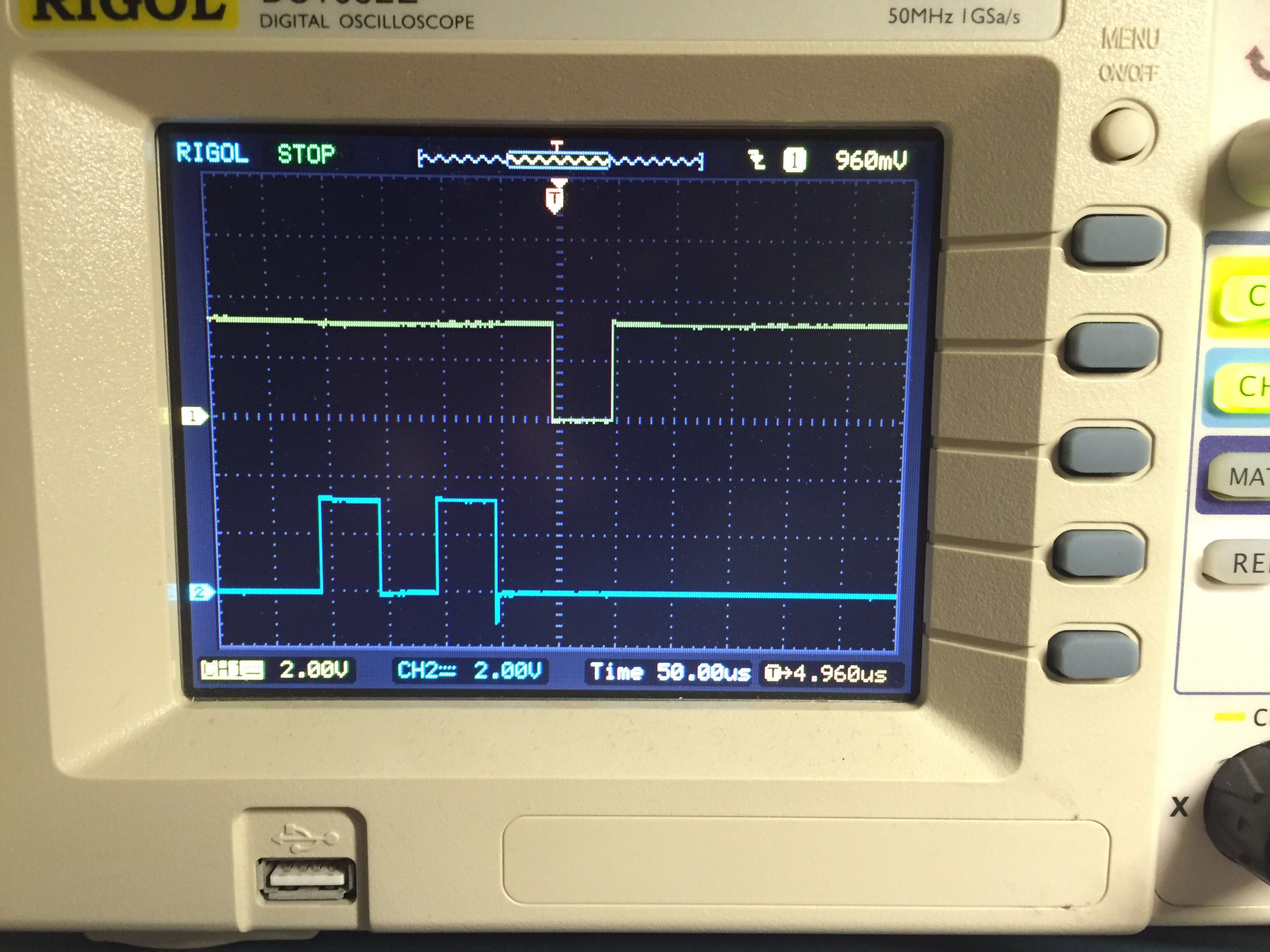

[CC430F5137] Unable to exit BSL
Hello folks,
I'm able to enter the BSL ok, here is the signal that I'm sending
However, I am unable to exit the BSL, here is the signal (based on the CC430 errata in JTAG20)
Other comments:
  • Pulsing the TEST line more times
  • BSL entry works because we are able to run the BSL scripter and the CC430 responds accordingly
  • BSL exit doesn't work because it never leaves the BSL and we know this from a solid LED in the user application
