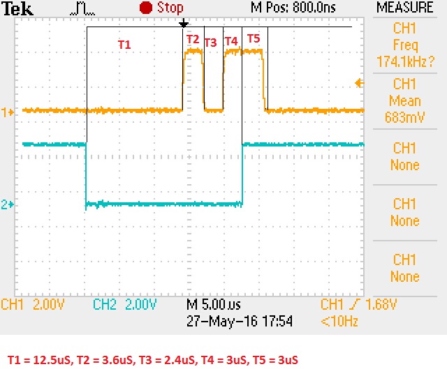

I'm trying to invoke BSL using 2 GPIOs of other MSP. But, after doing so, I'm not getting any response from MSP. The steps I followed are:
1. Flashed LED Toggle code on MSP that's to be upgraded.
2. Sent toggling sequence from other MSP. LEDs stopped toggling.
3. Sent Tx_BSL_CMD and didn't get any response back.
When forced MSP to enter BSL using software, I'm getting response back. So, there's some problem with the entry sequence.
Sequence:
Am I missing something obvious here? Please let me know.

  • Teja,
    Can you please try extending T2 to 110us as per page 49 of the FR5969 Datasheet under t SBW,en?
    If you still see issues, can you extend T1 as well?
  • Thanks for the reply.
    I've made the changed the time periods to
    T1 = 20uS
    T2 = 113uS
    T3 = 3.2uS
    T4 = 3uS
    T5 = 3uS
    But, unfortunately, there's no response from the other MSP. I've checked the physical connections to other MSP and the signals are going to the appropriate pins.
    Teja
  • Tejas,
    Before the RST goes low (beginning of T1) the TST should be low for > 100 µs (tSBW,Rst). This is not visible on the scope screenshot.
    If that is not helping I would try to relax the timings and try T2 >= 110 µs; T3 = T4 = T5 = 10 µs.
    Let me know if this works!

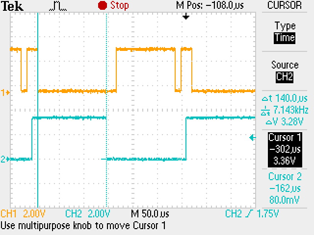

  • Hello
    Sorry for the late reply. I've made the changes. But still no luck.
    T0 = 140uS (TST Low before RST goes low time period)
    T1 = 20uS
    T2 = 120uS
    T3 = T4 = T5 = 12 uS
    Code in MSP that's sending sequence:
    GPIO_setAsOutputPin(JTAG_TEST_PORT, JTAG_TEST_PIN);
    GPIO_setAsOutputPin(JTAG_RST_PORT, JTAG_RST_PIN);
    GPIO_setOutputLowOnPin(JTAG_TEST_PORT, JTAG_TEST_PIN);
    GPIO_setOutputHighOnPin(JTAG_RST_PORT, JTAG_RST_PIN);
    __delay_cycles(960);
    P1OUT &= ~JTAG_RST_PIN;
    __delay_cycles(160);
    P1OUT |= JTAG_TEST_PIN;
    P1OUT &= ~JTAG_TEST_PIN;
    __delay_cycles(80);
    __delay_cycles(80);
    P1OUT |= JTAG_RST_PIN;
    __delay_cycles(80);
    __delay_cycles(80);
    SMCLK = MCLK = 8MHz
    Am I missing something here?
    Teja

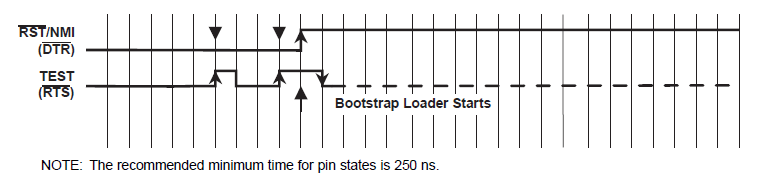

  • Hello!
    I've got it working after changing
    GPIO_setOutputHighOnPin(JTAG_RST_PORT, JTAG_RST_PIN);  to
    GPIO_setOutputLowOnPin(JTAG_RST_PORT, JTAG_RST_PIN);
    This, actually is mentioned in page 7 of SLAU550e. My bad. Should've given more attention to that diagram.
    Thank you  for the help.
