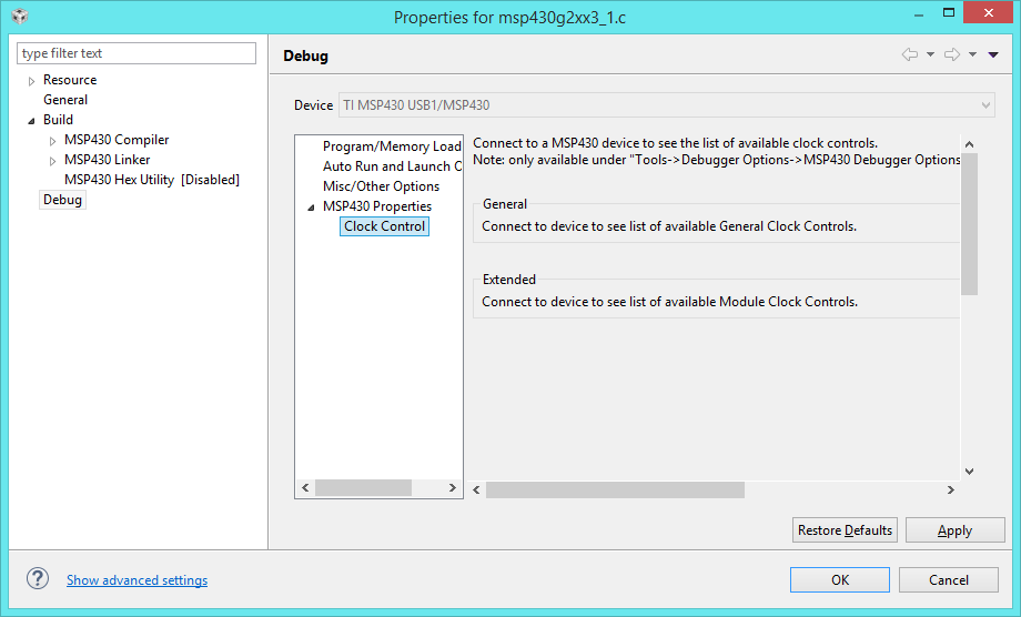

    I managed to debug several times buts it's not stable.
    I couldn't find the JTAG/SBW speed control. I tried at Project-->Properties-->Debug-->MSP430 Properties-->Clock Control (attached screenshot).
    Supply voltage is 3v (from the debugger).
    What do you think?
    Thanks.
    Sorry, my original post wasn't clear. The JTAG/SBW speed control is in the Target Configuration (.ccxml file):
    The voltage is OK.
    Itay Cohen67 said:
    What do you think?
    There was another thread where changing the JTAG/SBW speed to Slow made the debugging stable (https://e2e.ti.com/support/development_tools/code_composer_studio/f/81/p/517265/1878833#1878833) which is why I suggested changing the JTAG/SBW speed. SBW is sensitive to the capacitance on the RESET/SBWTDIO pin, so maybe also worth checking that C3 on your circuit is the correct value.
