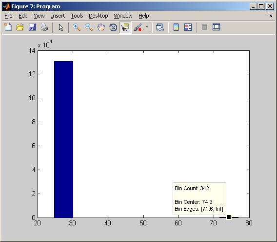

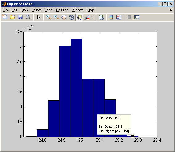

    I have modified my test program to run on a sample of MSP430F5xx and MSP430F6xx devices. The test setup is:
    a) Configure MCLK at 16MHz, with the DCO clock FLL reference set to a 32768 Hz crystal on XT1.
    b) Configure SMLCK at 1MHz, by diving the DCO clock, to give timers a microsecond resolution.
    c) Set timer A1 to generate an interrupt every 25 microseconds. The timer A1 interrupt handler simply increments a 32-bit tick count. The timer A1 interrupt handler and the interrupt vectors are placed in RAM. The timer A1 interrupt period of 25 microseconds has set to a value smaller than the minimum flash byte or word program time of 37 microseconds.
    d) Create a free running 32-bit hardware timer, with the least significant 16-bits from the timer A0 count and the most significant 16-bits from the DMA transfer count. The DMA is set to transfer one byte from P1IN to memory, where the DMA trigger is set to the compare output of timer A0 causing the DMA0SZ register to decrement by one when the timer A0 count rolls-over.
    e) Make the program delay for ~40 seconds with __delay_cycles(), to check that the 32-bit hardware timer and timer A1 interrupt tick count are advancing at the expected rate when no flash operations are in progress.
    f) Erase all flash sectors at addresses >= 0x10000 one at a time, with all flash erasure code in RAM. The change in the 32-bit hardware timer and timer A1 interrupt tick count are reported to see if the timer A1 interrupt handler is being blocked by flash erasure.
    g) Program all flash sectors at addresses >= 0x10000, with all flash programming code in RAM. The change in the 32-bit hardware timer and timer A1 interrupt tick count are reported to see if the timer A1 interrupt handler is being blocked by flash programming.
    h) Verify the contents of the programmed flash sectors.
    1) The test results for a MSP430F5438 Rev L device are:
    [Sun Jul 10 16:23:05] Starting 40 second delay for sanity check of timers
    [Sun Jul 10 16:23:49] Delay took 43690762 microseconds (start=2860, stop=43693622) and 1747631 ticks (start=115, stop=1747746)
    [Sun Jul 10 16:23:49] Starting flash erase of 430 sectors with timer ISR and flash programming code in RAM
    [Sun Jul 10 16:24:02] Flash erase complete in 11728384 microseconds (start=43697908, stop=55426292) and 469135 ticks (start=1747917, stop=2217052)
    [Sun Jul 10 16:24:02] Starting flash program of 430 sectors with timer ISR and flash programming code in RAM
    [Sun Jul 10 16:24:11] Flash program complete in 8256010 microseconds (start=55431013, stop=63687023) and 329380 ticks (start=2217242, stop=2546622)
    [Sun Jul 10 16:24:11] Starting flash verify of 430 sectors
    [Sun Jul 10 16:24:11] Flash verify complete in 106499 microseconds (start=63691023, stop=63797522) and 4260 ticks (start=2546782, stop=2551042)
    During the delay loop, the 1747631 interrupt ticks at a 25 us period = 43690775 us which is within one tick period of the elapsed 43690762 us measured by the 32-bit timer. This demonstrates the timer and interrupt tick count are advancing at the expected rate.
    [While the __delay_cycles() aims for a 40000000 microsecond delay the actual delay is longer due to an interrupt every 25 microseconds]
    During the flash erase, the 469135 interrupt ticks at a 25 us period = 11728375 us which is within one tick period of the elapsed 11728384 us measured by the 32-bit timer. Therefore, the timer interrupt in RAM continues to be handled at the expected rate while the flash erasure code is running in RAM.
    During the flash programming, the 329380 interrupt ticks at a 25 us period = 8234500 which is ~860 ticks less that the elapsed 8256010 us measured by the 32-bit timer. Therefore, with the flash programming code running in RAM there is some timing "anomaly" since the tick count is ~0.26% less than expected.

    To investigate the loss of some RAM based interrupt ticks when running on the MSP430F5438, modified the program to toggle a pin in the timer interrupt handler. Used a LSA to capture the toggle output from the ISR and calculated a histogram of the distribution of the interval between timer interrupts.
    When the main code was in a delay loop, the distribution on the interval between timer ticks was centered 25 microseconds as expected, with outliers out to 25 +/- 0.2 microseconds:
    With the main code erasing flash, the distribution on the interval between timer ticks was centered 25 microseconds as expected, with outliers out to 25 +/- 0.3 microseconds. i.e. a slight widening of the distribution compared to when the main code was in a delay loop:
    When the main code was programming flash, the distribution of the interval between timer ticks had a peak at 25 microseconds but some intervals were 75 microseconds which means 2 timer interrupts had been missed:
    Therefore, while the MSP430F5438 does allow RAM based interrupts to be serviced while programming flash, sometimes interrupts can be missed / blocked and so wouldn't rely upon servicing RAM based interrupts while programming flash with that device.
